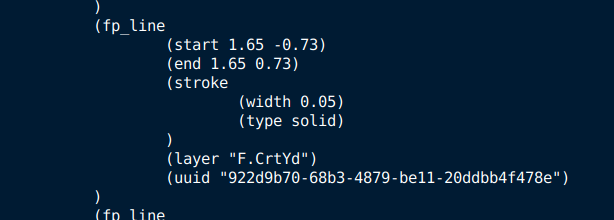

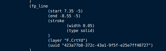

If opening the PCB in a Text-Editor, what gets listed for a Footprint’s Courtyard Layer?

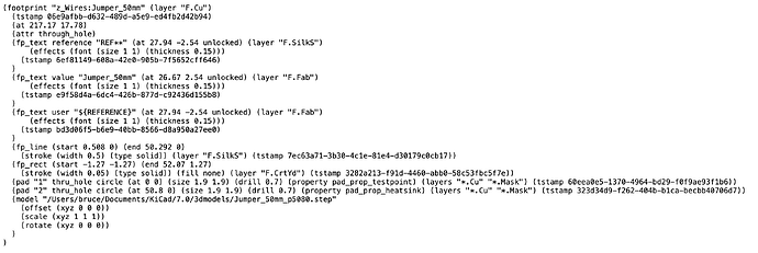

Here’s an Example of mine (typical of all mine that have Courtyards on Front…

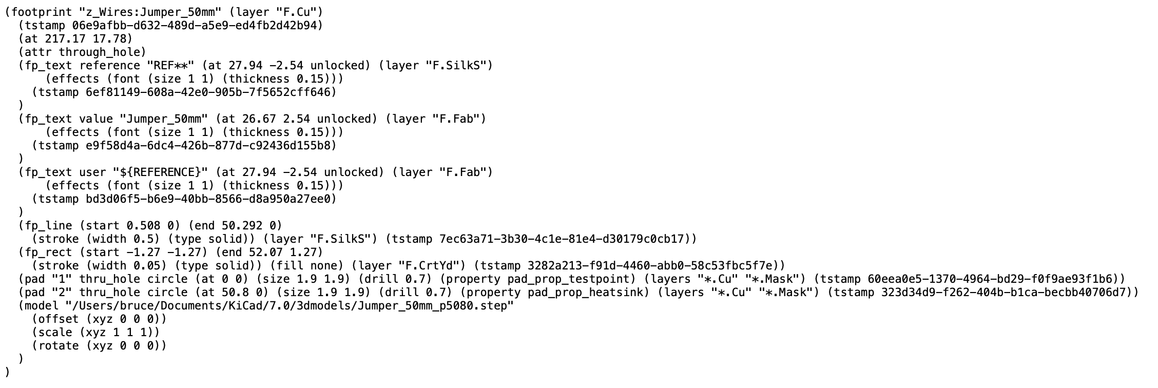

F.CrtYard for me (two different project which shows 0.0 before):

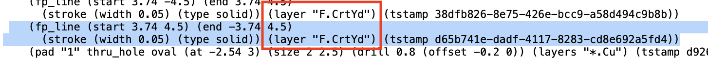

Don’t use this directly. Instead call GetCourtyard which will either return the cached courtyard or build the courtyard cache.
Also ensure your courtyards are actually completed and closed shapes.

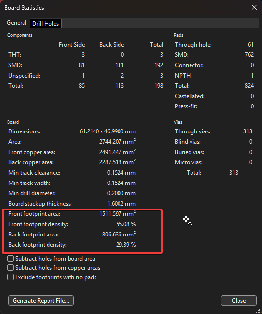

Any idea why we’re getting zero sometimes, even on the same board?
Board stats look good!
