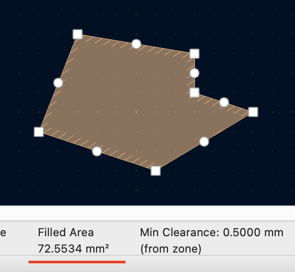

In v7, I do this to get Area:
For object of interest:
• On a Copper-Layer of your choice, Draw a Polygon-Shape to match the desired outline
• Select the Shape you just created
• Right-Click it and Create a Zone from it
• Select the Zone, Right-Click, Fill Selected
The Area will display at bottom of PCB Panel…
Multiple Zone Areas are not Additive so must do individually (and get out your calculator…)
ADDED: you can use other Layers to do it but, not all of them… User Layer works…

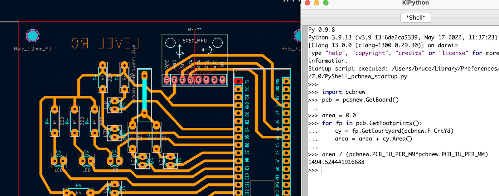

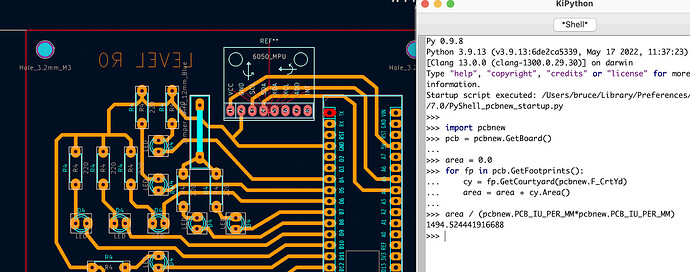

It is a Good start. And, after deleting Cached from Courtyard, it works (though, I did Not compare to actual Areas… just wanted to check ā€˜Cached’ issue…
import pcbnew
pcb = pcbnew.GetBoard()
area = 0.0
for fp in pcb.GetFootprints():
cy = fp.GetCourtyard(pcbnew.F_CrtYd)
area = area + cy.Area()
Here’s the Result:
area / (pcbnew.PCB_IU_PER_MM*pcbnew.PCB_IU_PER_MM)
1494.524441916688

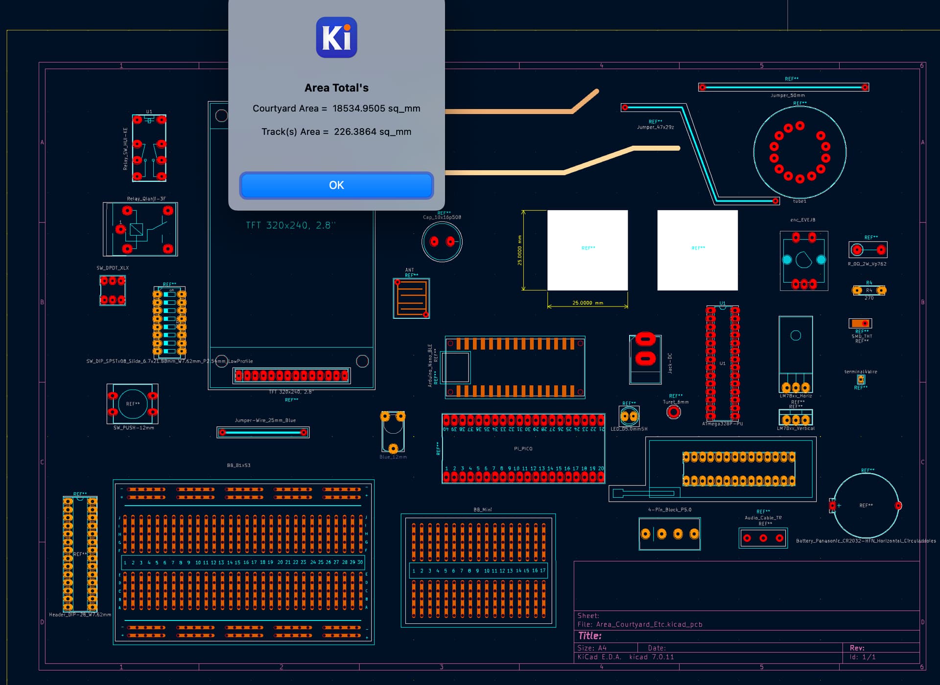

I added Courtyard-Area calc to my Selected-Track’s-Area Plugin.
Tested with Two Courtyards at 25x25mm. I left it such that User needs to select desired Tracks and Courtyards are on Front
Plugin attached - old style so, just put it into the proper folder on your system and Edit the .PNG name to your desired Icon.
my_Area_Calc.py (1.5 KB)

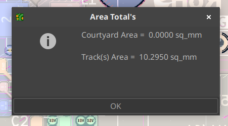

Many thanks for this.
Tried it on a few different projects and it reposrts tracks OK, but no Courtyards.
Tried selecting them with F.Cu or F.Courtyard layer active. No luck:
It there something wrong with my system (Xubuntu + KiCad 9.0.5)?
What do I do wrong?
I’ll check it on another machine (Win11 + KiCad 9.0.4) after the weekend and let you know.
