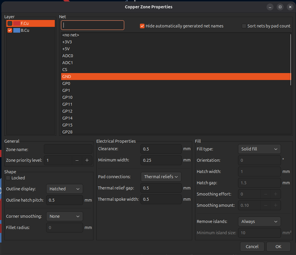

“Toggle Net Highlight” Disabled and Cannot Draw Ground Fill Zone in PCB Editor (KiCad 9 on Ubuntu)
In the PCB Editor, I can see all footprints and ratsnest connections.
However, when I Ctrl+click any pad or try to Highlight Net, the “Toggle Net Highlight” option is disabled, and no nets are highlighted.
Additionally, when I try to draw a copper fill zone (for example, to connect to GND), the zone is created but does not fill — it remains an empty outline, as if no GND net exists on the board.

    Images are attached for reference.
We need your exact KiCad version and OS information

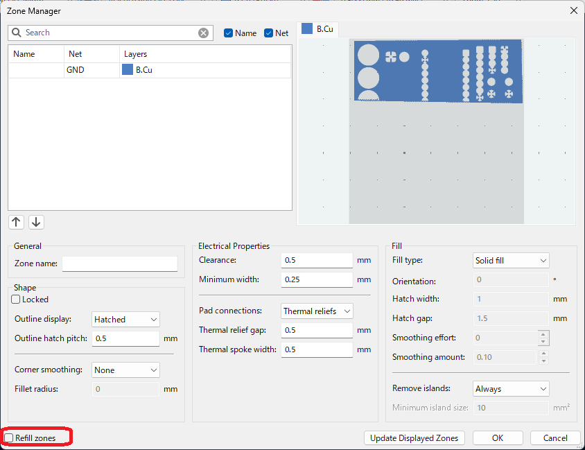

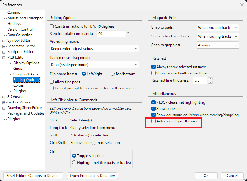

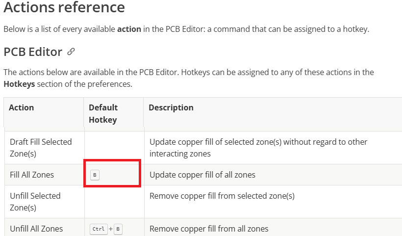

Try pressing ‘b’ to re-fill the zone.
Also ensure the top of these two icons is selected on the left icon strip.
