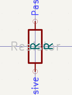

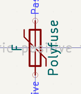

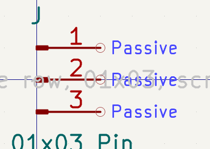

This is not manufacturer specific . . .
neither is this . . .
or this . . .

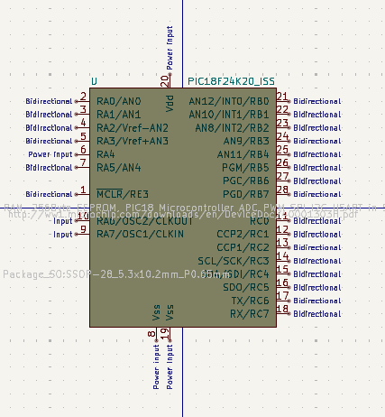

This is . . . because only one manufacturer makes this device . . .
Very wrong, KiCad has always favoured using generic symbols and footprints and avoided “atomic” symbol+footprint+3d model approach used by Eagle etc. The atomic model scales badly into huge libraries. Was the OPs post using AI?

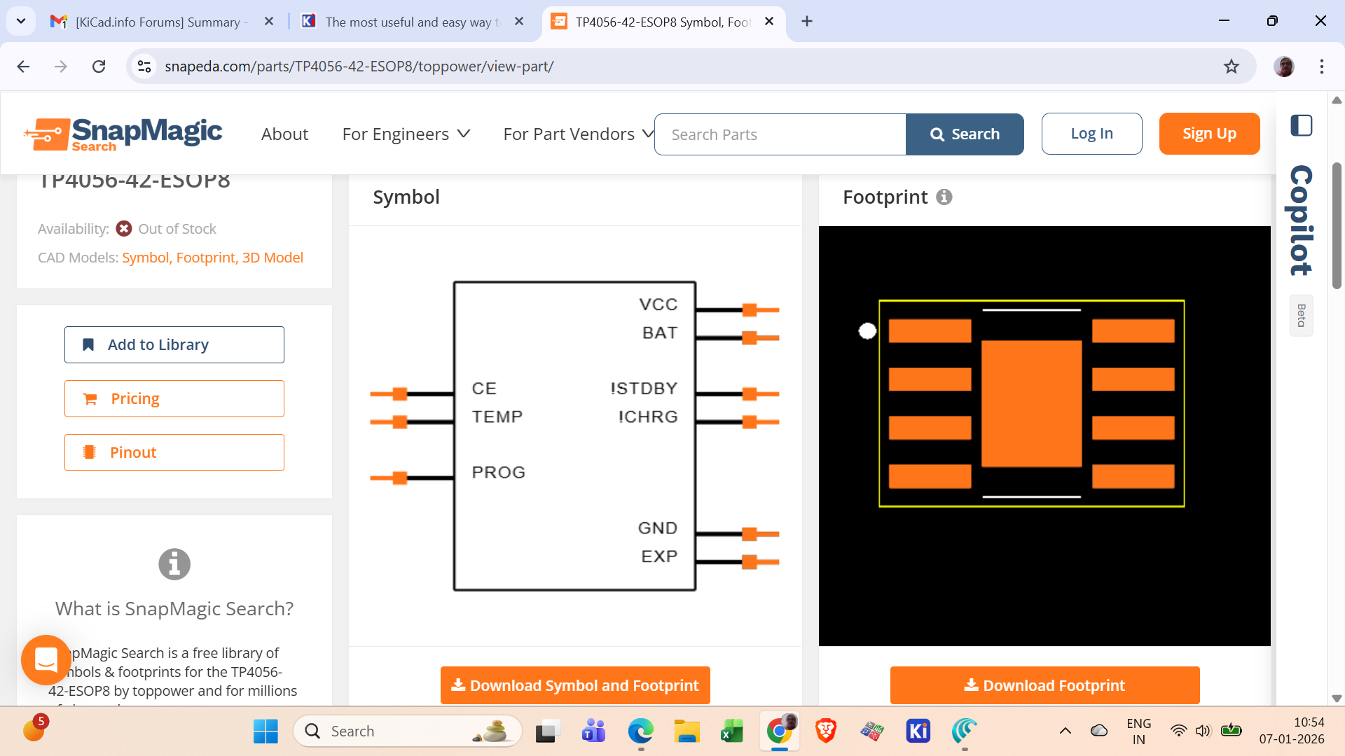

I am into led lighting and maximum IC are made in China.
They use ESOP8 package for linear ic .
I searched for ESOP 8 , BUT could find one .
I belive dummy or shell under new library will help a lot .
