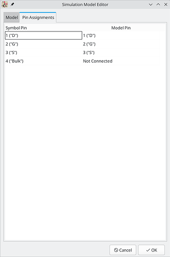

https://docs.kicad.org/master/en/eeschema/eeschema.html#simulation-pin-assignment
Simulation models may have their pins numbered differently than the corresponding symbol. For example, SPICE models for diodes usually consider pin 1 to be the anode, while schematic symbols are usually drawn with pin 1 as the cathode. Operational amplifier models are also very likely to have model pin assignments that do not match package or schematic pin numbers.

As tama suggested, do the pin assignment. It is wrong or not done in your example.

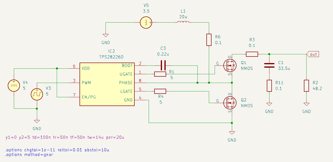

Add some options suitable for power supply simulation, as we typically have larger voltages compared to IC simulation (see circuit diagram attached).
The circuit:
Reduce the inductance
Remove most of the 0.1 Ohm resistors (except for series to L)
Increase the gate resistors.
The resulting circuit is

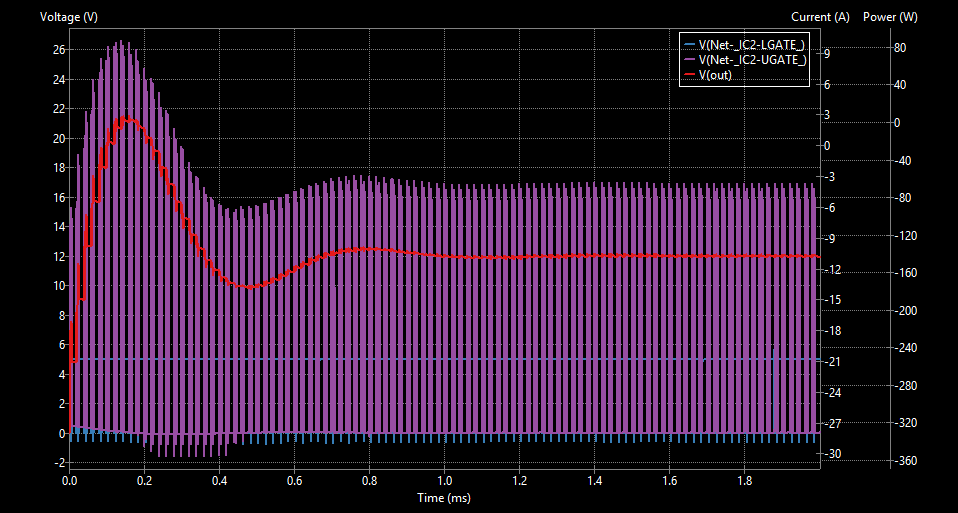

If I do these changes, I get as a simulation result

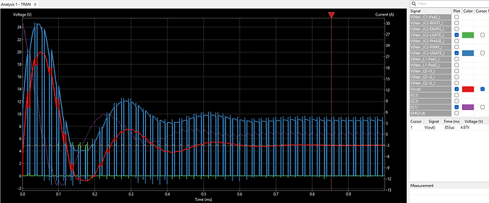

I made all the changes you suggested after this line:
And while my simulation runs, it still looks nothing like yours. UGATE never actually turns on fully:
Sanity checking tells me that in a SMPS, LGATE should turn on first to charge the bootstrap cap. This leads me to believe that the pin assignment really is the last piece of the puzzle. How did you fix it on your end?

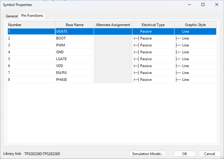

I followed the link @tama sent and the closest I could find in my version of KiCad is this, which looks fine to me.
And then I think to look in the .lib file, where the subcircuit reads as
.SUBCKT TPS28225 PWM LGATE VDD UGATE EN/PG PHASE BOOT GND
Is this what you two mean by pin assignment?
No “Symbol Properties“ Pin Functions tab

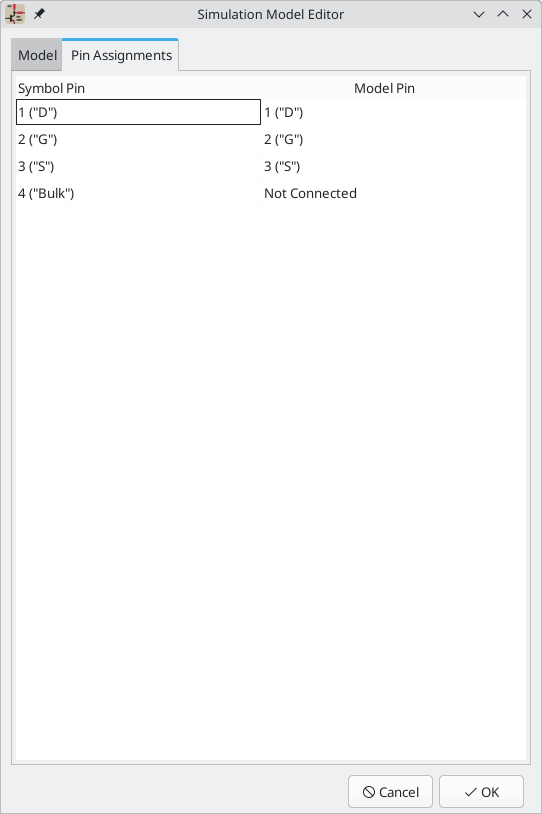

”Simulation model” Pin Assignments tab
Thank you both! I’ve done more in the past 10 hours than I have in a week.
Also now is a good time to find out that “tw” is the offtime of the signal, not the duty cycle. tw = 5.5 gets my my desired output voltage of 12V. Now I’m off to add an actual PWM chip and design my first PCB.
