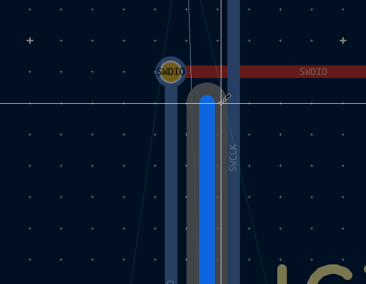

I am having a problem routing a track - it would appear that there is a large clearance rule (I assume that is what the semi-transparent area is around the track). The track is 0.25mm thick making the clearance a similar value I would guess.
In Board Setup→Design Rules→Contraints, I have set up a minimum track clearance of 0.05mm but that does not seem to affect the track routing. Are there design rules specified somewhere else that I am missing?

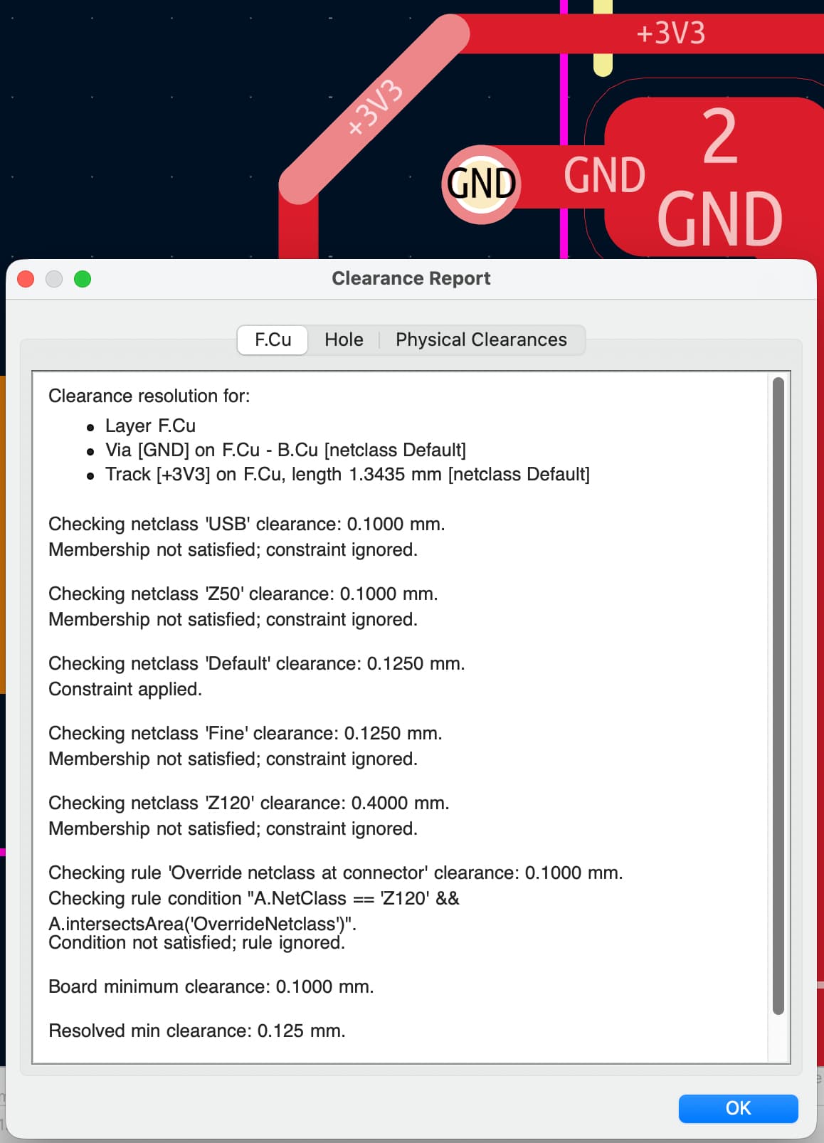

There’s a great tool in the “Inspect” menu called “Clearance Resolution”.
For example if I run it on this track and via, I can see all the constraints and why they do or do not apply, and what the final constraint is that is applied. The constraints checked include the global constraints you mention, plus the netclasses, plus custom design rules I’ve set.
