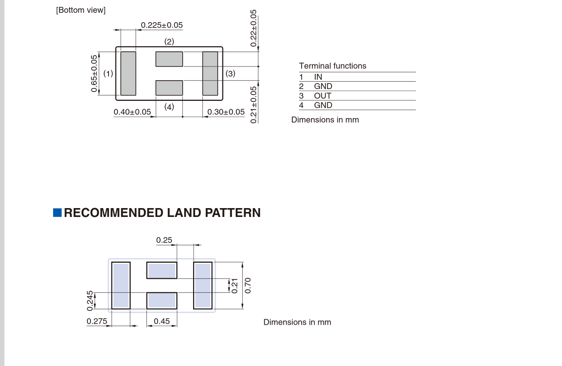

I created a footprint for a TDK low pass filter according to its data sheet here at:
https://product.tdk.com/system/files/dam/doc/product/rf/rf/filter/catalog/rf_lpf_dlf162500lt-5028a1_en.pdf
The pads and land pattern diagram are shown as below:

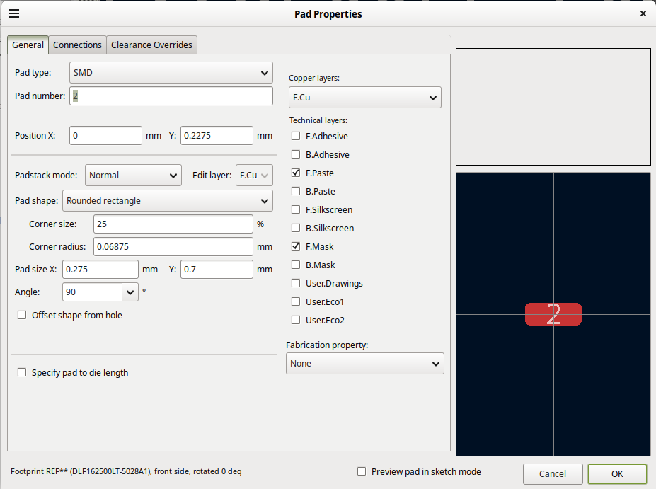

Using the footprint editor, I created a footprint for this part. The setup of the footprint is as below for pads 2 and 4:

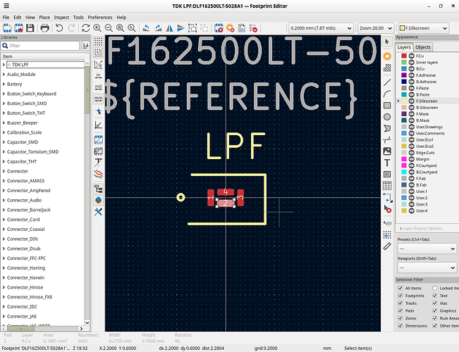

Pads 1 and 3 are at y =0 for both and pad 1 is at x = -0.6125mm while pad2 is at x= 0.6125mm. Please see that pads 2 and 4 are at y = 0.2275mm and y = -0.2275mm and at x=0 for both. From this, pad 2 should be on top of pad 4 but pad 2 is appearing down and pad 4 is appearing up as shown in this diagram.

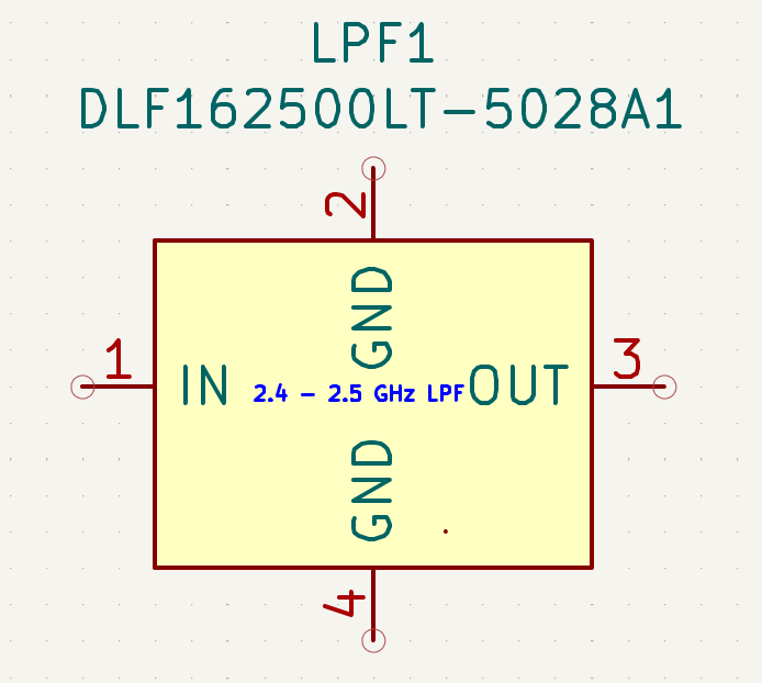

The footprint is shown as below in the schematic.
The footprint should look like that but pads 2 and 4 are reversed in position.

By default, Y coordinates increment while going downwards. You can change this in the preferences, or you can just change the pad numbers.
But at the moment your footprint is already the same as in the datasheet (by coincidence). Look closer at the datasheet. It shows the bottom view of the part. I was alerted to this, as the normal convention is to number pads counter clockwise when seen from above.
For the symbol editor, you can simply rotate the pins. KiCad is a bit confusing sometimes with left / right / top / bottom. As an alternative, you can also give both GND pads the same number in the footprint editor, and then only use one GND pin the schematic. KiCad simply assumes that pads with the same pad number always have to be connected to each other, and this cleans up the schematic a bit.

Where is this located in preferences? Usually, positive Y means going upwards as seen by the viewer with view towards the part on the PCB. I follow this convention.
Preferences / Preferences / PCB Editor / Origins & Axes / Y-Axis / Increases up

This fixed the positions of pads 2 and 4. Now 2 is up and 4 is down as required for the top view of the part in datasheet.
Huh? The top of your screenshot states: [Bottom view], as I already mentioned earlier. (sigh).
TDK created that spec. I’m aware of the small clearance between pads 2 and 4 which is 0.21mm. It appears that the PCB manufacturer would change it if the part has a different clearance.
Just as you have done, I see it as correct.
A bug? Why? You can orient the symbol pins however you want. They don’t have to match the orientation of the footprint pads.
I changed the origin and direction of Y axis as pointing upwards. Now, pads 2 and 4 are as in the datasheet with pad 2 up and pad 4 down. The default settings in KiCad had Y-axis pointing downwards.
