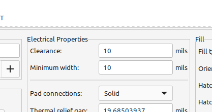

If I tell the zone fill my electrical properties have a 10 mil clearance and a 10 mil Minimum Width and I tell the Board Setup Constraints Minimum clearance 7 mil and Minimum Track width 7 mils, I do not expect the Zone Generator to create DRC errors.
But it does.

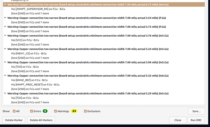

Here is the situation in the first DRC warning.
Why does the Zone make a connection that is 6.75 mils wide, when I told it the minimum connection should be 10 mils? Is the “Electrical Properties Minimum Width:” in the “Copper Zone Properties” ignored when generating zones? If it cannot make a connection at 10 mils, then it should not make a connection. It should not make a connection at 6.75 mils. Am I missing something?

The 6.75mil width is a result of the narrow gap between the two vertical tracks and further reduction for the via. There simply is not enough room to make the track wider. (At best, you can move the via a bit further to the right).
When you set PCB Editor / File / Board Setup / Design Rules / Constraints / Minimum connection width to 10 mils, that just means that copper connections that are narrower then 10 mils get flagged as DRC violations.

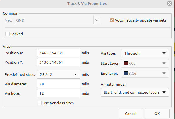

Also: Your via’s do not look right. The annular ring (the white part) is much to narrow, and PCB manufacturers can not make a reliable PCB with that geometry.

paulvh, there are two sets of parameters. The one you are talking about are in the design constraints. And that is 7 mils minimum clearance. And 7 mils minimum connection width. And that sets the DRC violation.
However if you look in the zone parameters There are two parameters under electrical parameters Clearance: 10 mils and Minimum width: 10 mils. If it is set like that it should never make a connection less than 10 mils in a zone. But it was in version 7. But not in version 9.
As for the via, it has a 12 mil hole diameter and a 28 mil ring outer diameter. That is 7 mils from the hole edge to the outside edge of the ring. I have not had a manufacturer complain about that. Many will go down to 5 mils from the hole edge to the outside edge of the ring, but I do not like to push it. I try to design for ease of manufacture. Not to push the edge of the manufacturer’s capability.
In my opinion you didn’t told Zone what the minimum connection width should be, but you told it what a minimum track width it can use to fill zone. Where 10 mils track can’t go you get two tracks touching each other partially and get for example 7 mills width connection. At the same place if you allow Zone to use 8 mils track it is possible that 8 mils will be able to go there.
