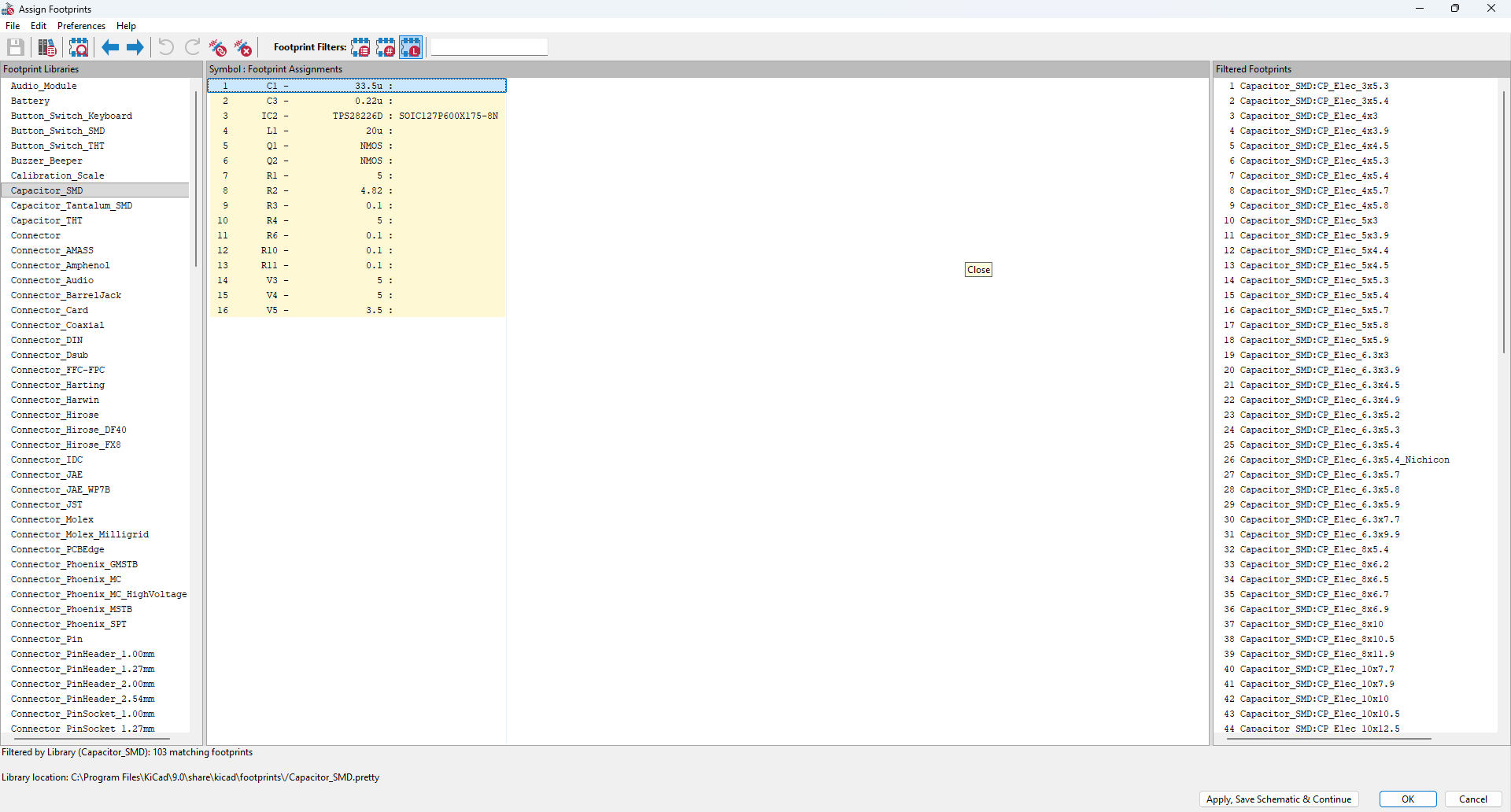

Hello all, I am trying to design a PCB from a schematic I’m at the step where I have to assign footprints. What should my considerations be with all of these options? For example, 5x5.3 or 3x5.4? Should I use these default footprints, or would I be better off finding the components on Digikey and finding the specific footprints on SnapEDA?

There are millions of differently sized electronic parts in this world, and in the end you have to fit the parts that you have on the PCB that you made.
Those numbers refer to the diameter and the height of the capacitor. The height will not have an influence on the footprint, but you can see it if you turn on the 3D preview.
KiCad’s own libraries are of a quite high quality, and I use them whenever possible.

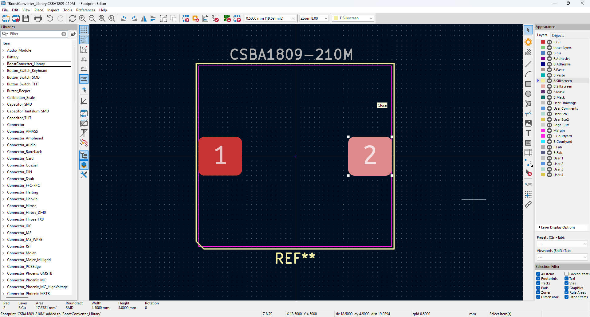

Ok for example, I’ve got this inductor I want to use. If I’m reading this datasheet pdf correctly, it’s 18.2mm x 18.2mm. But I can’t find anything that size in the default footprints in KiCad (but I am new, so I’d appreciate someone doublechecking me on that). Would I now design my own footprint?
I’ve attached my best first attempt in the form of an image and as the actual footprint if anybody would like a more detailed look.
CSBA1809-210M.kicad_mod (2.9 KB)
CSBA1809.pdf (1.5 MB)
Very good EXCEPT, you have made a drawing of the inductor instead of the Footprint for the inductor.
You need to create a footprint for the “Typical Land Pattern”. ie. Pads 6mm sq. and F. Courtyard of 19.3mm sq.
Anchor is good. F.Fab is missing.
F.Fab should be the size of the component ie. 18.2 X19.3 mm
F.Courtyard could be 19.3 mm sq. as per land pattern.
F.Silk a little larger than F.Courtyard.
An easy way to remember what layers are needed is to use some other rectangular footprint with two pads in the footprint editor then right mouse click each pad and change the size in Properties and Drag and Move the three outlines until they are the correct length in the correct places.
