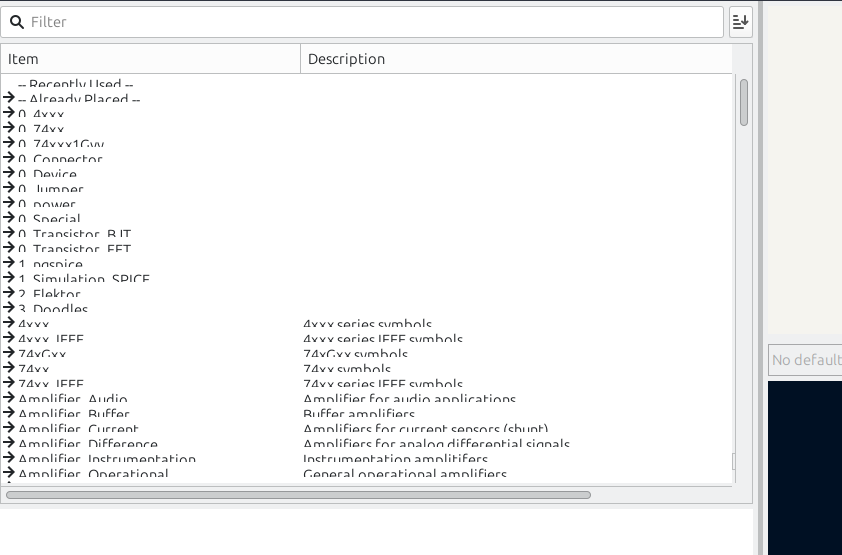

I’m experiencing a very strange behavior when opening a schematic from the Project screen:
Clicking the “Place symbol” icon oddly loads and opens the symbol list (and loads the footprint list as well), and it looks like this:
Not nice. I get the same distorted text when opening the Symbol Editor from the Project page.
All my editors are set to “Fallback Graphics”.
I never saw anything like this in 8.0 (which works like a dream).

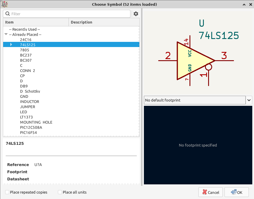

All is normal for me on 9.0.6 on Ubuntu and 9.0.6+Testing on Windows x64
This should be fixed since wxWidgets 3.2.7, see:
Well that leaves me stuck. Searching for wxWidgets upgrade only brings me source code to compile, which is outside my competence. Why doesn’t a KiCAD upgrade also upgrade wxWidgets?

Checking 9.0.6 on Windows and the latest 9.0.,6++ Testing, both are built on wxWidgets 3.2.8, so this is likely a Linux versioning quirk. But my Ubuntu 24.04 LTS still shows symbols as expected.
This is theme-and-font-dependent.
It should be possible to work around by putting something like:
  -GtkTreeView-expander-size: 21;
into ~/.config/gtk-3.0/gtk.css
Or change your system font to one that uses less vertical space.
Another workaround is to use Flatpak.

OK.
After the reinstall, the same issue occurred, But after a couple of invocations of KiCAD with reboots in between, it’s gone now. That leads me to the hypothesis that something was wrong in my user configuration files (on a separate partition and not overwritten by the reinstall). The wxWidgets version is still the same (3.2.4) so that can’t be it.
