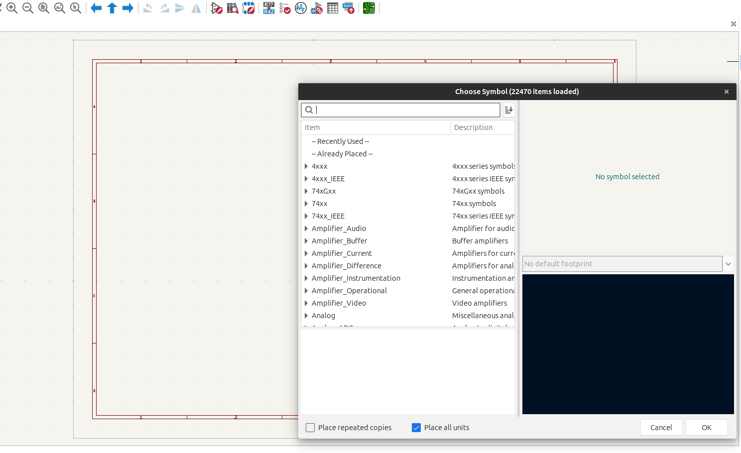

Been using and loving Kicad since V 6, but have sold a physical project and want to provide the owner with schematics.
As many other posts here, the problem is in a previously working project the schematic is empty. Also true of the PCB but I’m not using that or concerned about it. On opening the schematic, no errors but a brief flash showing it’s loading the components. When I add new symbol you can see “already placed” but nothing renders.

EDIT: Opened some other old projects and they’re fine, when I look at the BOM there are no items in the list so my initial assessment of “already loaded” is incorrect. It’s something else. As I mentioned, I can see a flash of “loading” and references to symbols. I’m at a loss.

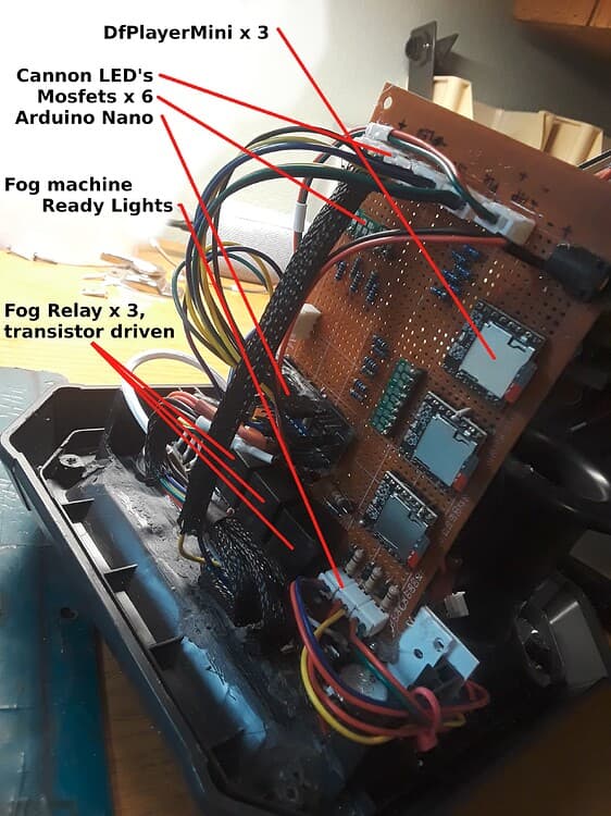

Thanks, when something goes wrong by experience, I always think it’s something stupid I did (which is probably still the case.) I have hunted everywhere, even in DVD backups. I even went to all the sites where I seek help from time to time and no schematic. I have an “old version” that uses different components and is missing the fog relays, I have individual test projects of the lights, sound cards, and fog relays, but between January and May there is zilch, nada, nothing. I know the last I touched it was in may because I completed this in May 2024:
I know it would have to be in May, all the .ino timestamps for the Arduino code carry that date. And no matter how nerdy I think I am I would have NEVER tried this without a full schematic:
