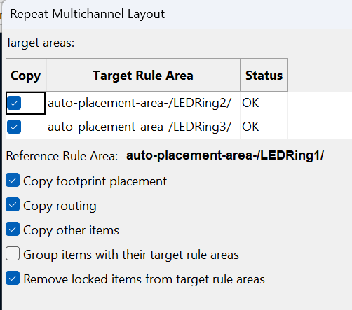

Hi all, I am currently designing an LED ring/encoder test board. I made three identical channels, but unfortunately repeat layout fails.

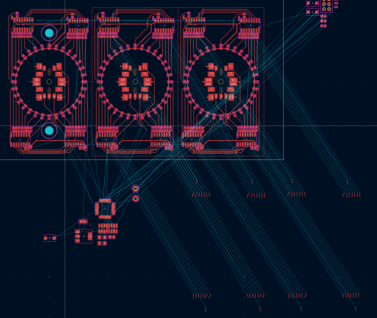

Before: Three rule areas, configured as described in the manual. Channel 1 mostly routed, channels 2 and 3 with previous placement, moved out of the way.

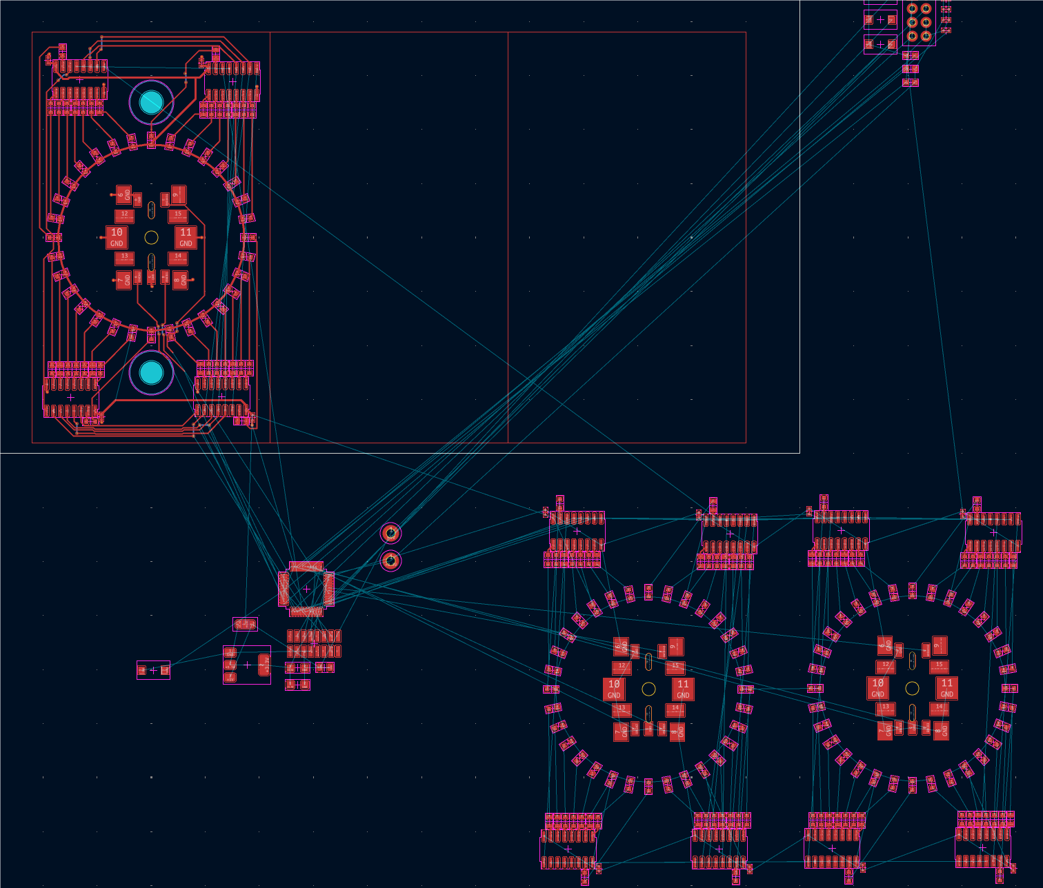

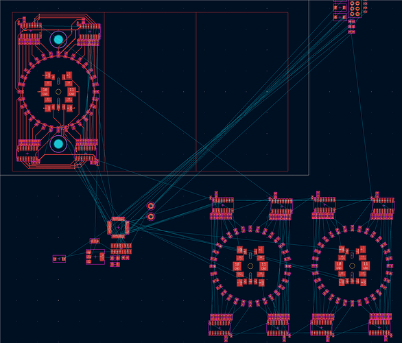

Tools Multichannel repeat layout seems OK
But there are a number of bugs:
  • (some stray track segments remain in the wrong position) EDIT those were in the initial layout so would be a duplicate - disregard
  • Mounting holes are not replicated
  • Rule area 1 is deleted

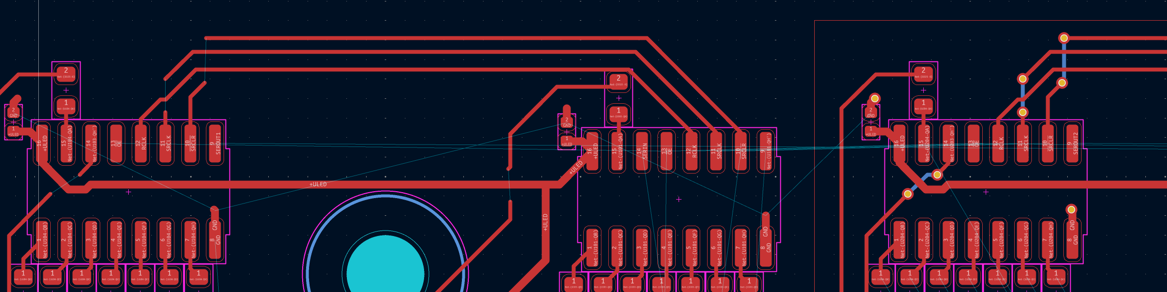

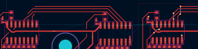

  • Vias and bottom layer tracks are removed from channel 1, but present on 2
Any idea?
I attached the project.
Steps to reproduce:
Open the project with KiCad 9.0.6
Open the PCB
Select Tools Multichannel Repeat layout
Select Rule area 1 (the leftmost which is somewhat routed already)
press OK (leave at default setting)
Version: 9.0.6, release build (also tried on current nightly, no change)

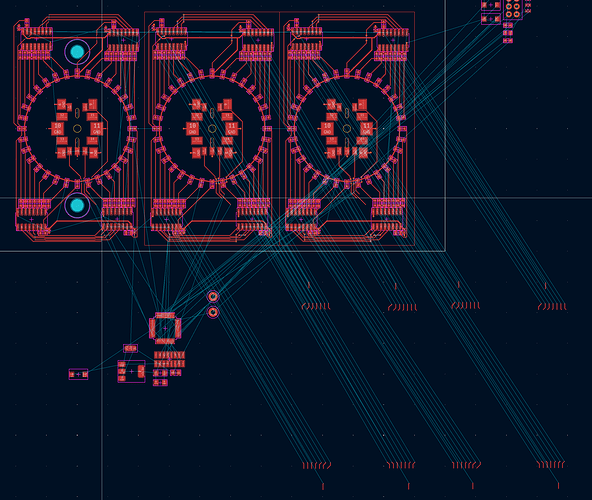

What error are you talking about? You have a ton of errors both in the board and in the schematic.
Layout is unfinished, that was just a test run.
As I wrote, the repeat layout process deletes some of the rule areas and the bottom layer/vias of the original, which is not the correct/expected behaviour.
Whatever the state before was, repeat layout should just do that - repeat.
First, you need to complete the circuit. If you make a stupid duplication without reference to the circuit, then Kiсad will not know where to connect them.
I can replicate your issue entirely with v9.0.6 and a decently recent v9.99. There definitely shouldn’t be things getting deleted, and I have no idea why the mounting holes aren’t getting moved.
To report this as a bug, open KiCad > About KiCad > Report a Bug (or KiCad > Help > Report a bug). Either will open a Gitlab issue page with part of the template already filled out. If you don’t already have one, you’ll need to make a Gitlab account. Make sure to include everything you’ve included here, including the example project.
I downloaded your project with the intention of having a look, I need to get familiar with Multichannel for a work project . . . I just didn’t find time so far.
Well, that’s a case that does not work (although I believe it should). The docs mention a sample project included in the distribution, maybe have a better look at that.

Filed a bug: Multi channel repeat layout fails (#22280) · Issues · KiCad / KiCad Source Code / kicad · GitLab
