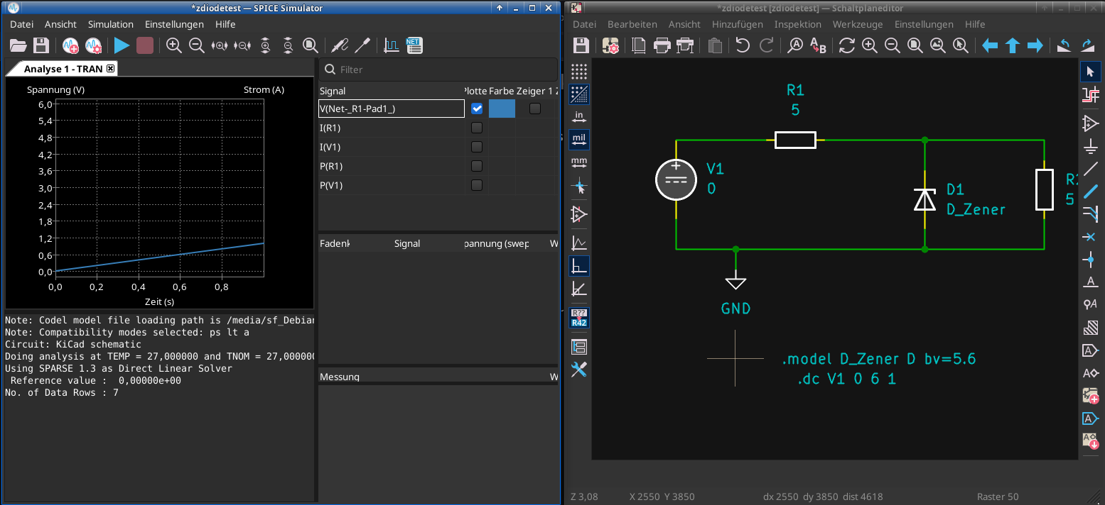

Hello together,
What’s wrong with my DC sweep setting? It should go from 0 to 6V in 1V increments, but as you can see here, that’s not what’s happening.

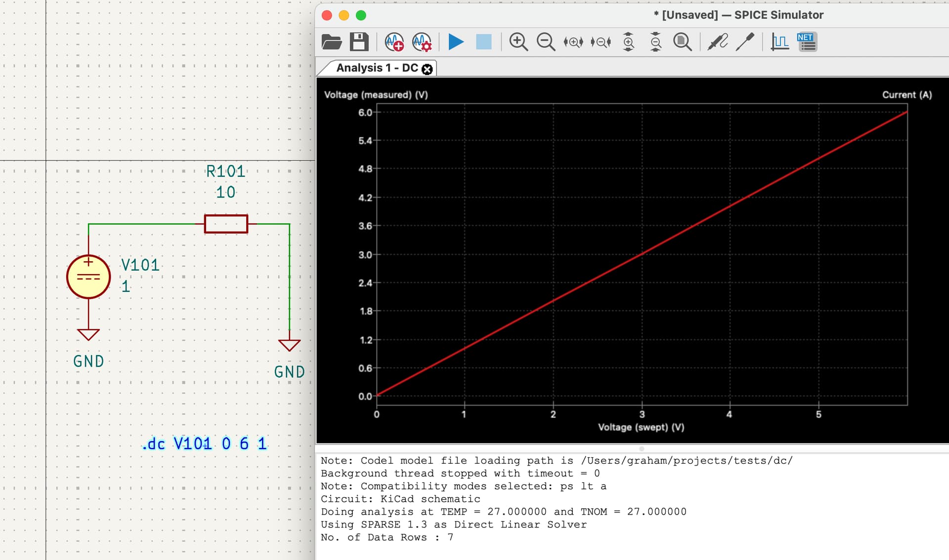

For some reason you’re looking at a transient simulation and not a DC sim.
I set up a similar sim in 9.0.6 and got this:

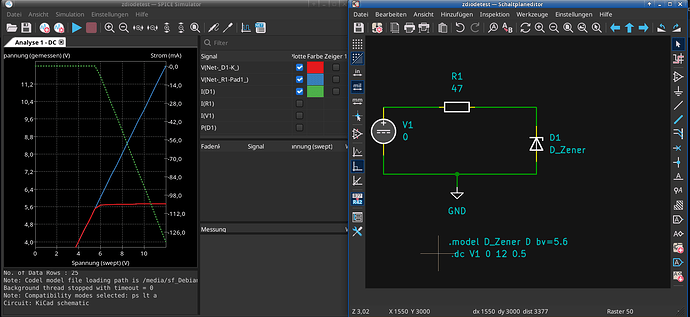

hello gkeeth,
I’ve now changed it a bit and it works. I want to test Zener diode models this way, and I’ll try it like this first. Thanks anyway for your answer, and here’s my solution.
Also, do note that the earlier transient analysis has time on it’s horizontal axis, while the DC analysis has voltage on the horizontal axis. This is a quite fundamental difference. I would prefer to use transient analysis here, and combine it with a voltage source that ramps up it’s output. (for example with a PWL source). This way you can also simulate the result of added smoothing capacitors, or (rectified) input from an AC source.
