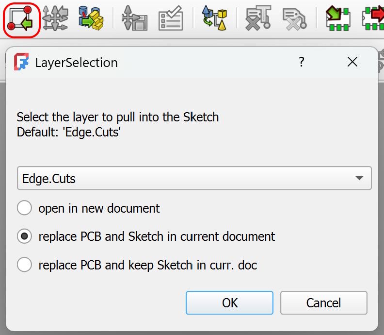

particularly with the Pull Layer to FC Sketch button

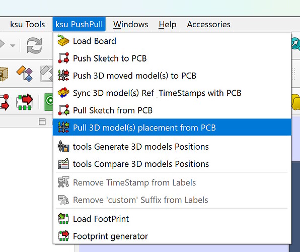

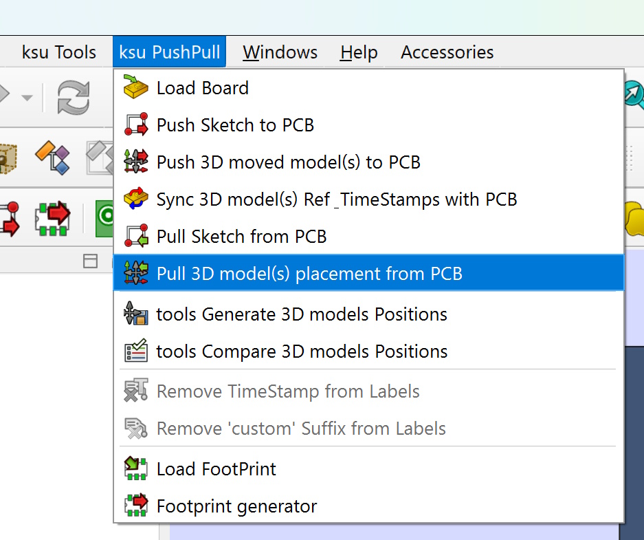

For model positions use instead the Pull 3D model placement from PCB button

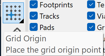

Moreover, it is a good practice to put a Grid origin (or a Drill origin) to your kicad file, then the origin of your FC sketch would be placed as the origin of your KC file.
(you need to configure FC kSU preferences accordingly)

  • Pull Layer does not seem to list the layer on which the new component is placed (back of the PCB). I also don’t know if it’s meant to pull components/models.

a) if the 3D model is new to the board, import the 3D model in FC document; if the 3D model is a duplicate of an other model in the same board,’ Make a link’ of the 3D model which is to be duplicated
b) Drag the object inside the ‘Step models’ ‘Top’ (or Bot’) Part container of original PCB structure
c) ‘Sync 3D model Ref’ using the kSU button, and input the ‘REF’ of the added footprint
d) ‘Pull the 3D model placement’ using the kSU button
That will sync MCAD with ECAD even with added footprints and models.
