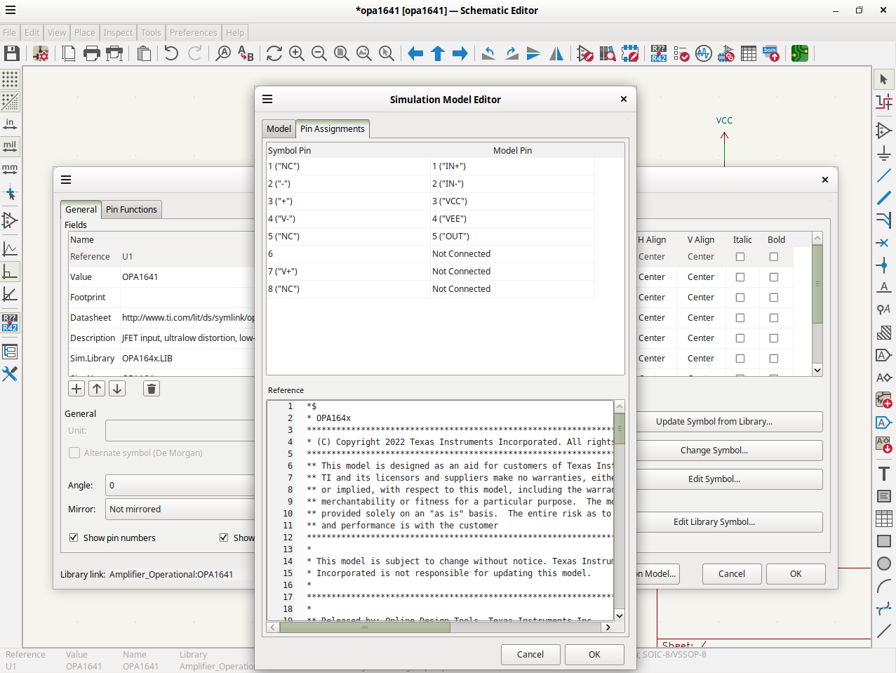

I canât look at your project directly as I am still using KiCad V8 but claiming:
is premature. Quite often the pin mapping of spice models is different from the pin mapping of the symbols in KiCad, and you have to add a translation table in your symbol properties with: Symbol Properties / Simulation Model / Pin Assignments (tab)
From the spice model file:
.SUBCKT OPA164x IN+ IN- VCC VEE OUT
And that defines the 5 pins (with pin numbers 1 through 5) for the spice model. (I.e, IN+ is pin number 1 in the model, OUT is pin number 5 in the model)

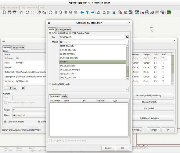

I tried setting these pins as above in the model and it doesnât work. I am attaching screenshots of the settings.
This selection gives an error in ngspice simulation.

The option 1 or 2 in image 1 gives output as a replica of input. The Pin 5 is NC in these models and there is no OUT configuration for pin 5 in these selections and the pin 5 is not configurable.
KiCad is also crashing if selecting a few sub selection options in opa1641.lib in image 1 and clicking Ok.

Your pin mapping is obviously wrong (as I suspected). You are just using the default mapping (one to one, two to two, etc).
Note that in this Pin Assignment tab, the Symbol Pins on the left are from the symbols (duh) and the symbols have both pin numbers, and pin names. while on the Model Pins on the right, the order (1 through 5) is implicit by the .subckt pin ordering. Now try to create the following mapping:
(I assume here that pin 6 is the opamp output, this usually has no text in the symbol of an opamp, as itâs function is implied by the triangle outline of the opamp).

Thanks for the mapping. I did the same now. Even after that, I get the same error in ngspice. I am quite new to ngspice so I have to wait until an expert on ngspice can answer this.
Strangely , OUT pin at pin# 6 left is missing in the model.
