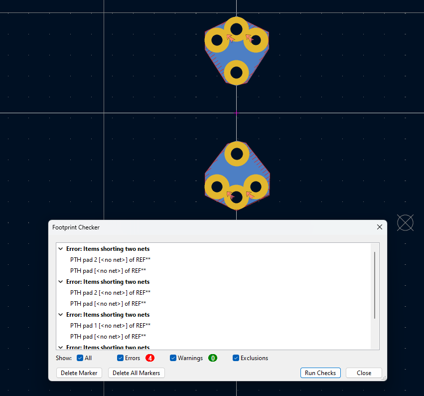

Been a while since I was here - I’m solving most of my problems on my own, but this one has me stumped. I’m trying to make a 5x20 fuse holder that uses two different types of fuse clips. The holes are all lined up, etc, measurements done, etc. I’ve joined the pads up with a polygon-filled shape, but I am still getting all the holes individually numbered. I really only want one hole on each shape to be the master hole and numbered 1, and on the other 2. I looked at an online video, but it doesn’t really cover this type of component. The ‘footprint checker is throwing up multiple errors as you can see below. Any ideas where I should start? One other thing, I want to pads to be joined where possible via thermal relief pads. When I tried to do this via the pad editor, it does not seem to work either (I’ve done the ctrl B to redraw thing).

Give all of the 4 connected pads the same pad number. So that is 4 pads with pad number “1” and 4 pads with pad number “2”.
ok - I’ll try that and see what happens!
Its worked - thanks :slightly_smiling_face:
