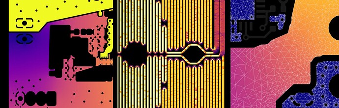

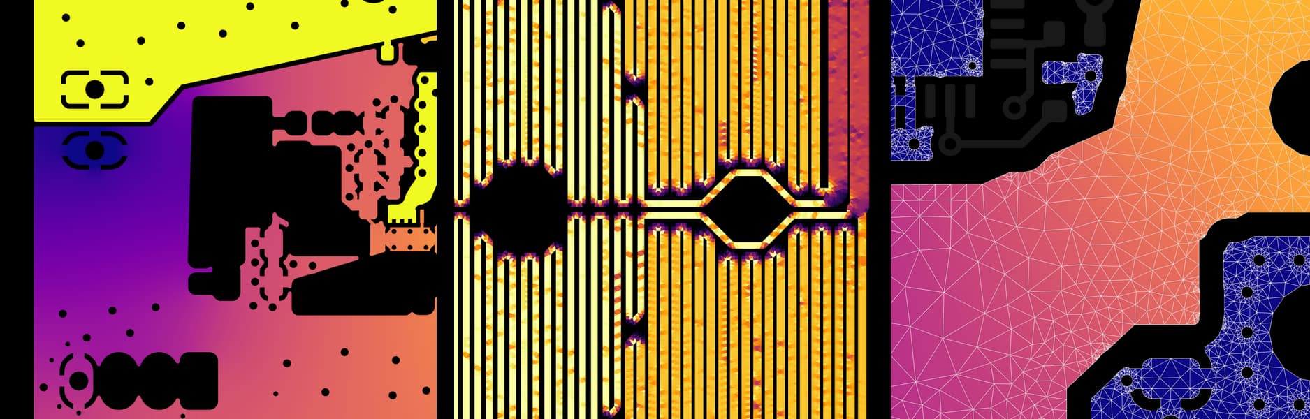

For the last few months, I have been casually programming a DC power delivery network simulator that works with KiCad projects. This is mostly a fun side project intending as a finite element method practice, but I have used it in my day job for some high current PCB design.
What it does: Simulates DC voltage drops on your PCB using the finite element method. Basically, it shows you where voltage drop occurs on your PCB power distribution traces and planes.
How it works: You add text directives describing your sources and sinks into your schematic, such as !padne VOLTAGE v=3.3V p=U1.1 n=U1.4 to describe a voltage source of 3.3V between pins 1 and 4 of U1, then run a command and get an interactive GUI where you can zoom around your board to explore the voltage/current distribution.
It lives on Github here: https://github.com/atx/padne , maybe it is going to be useful or interesting to someone else too. For now, it is very much a work in progress tool, but I am feeling good enough about it to start showing it to others.

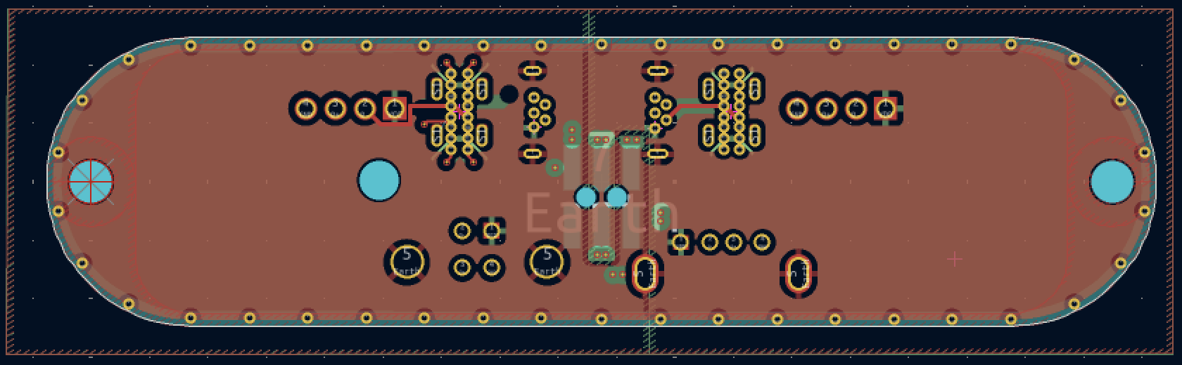

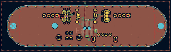

I may know about the segfault, as I was investigating a similar crash last week: it turns out that pygerber sometimes leaves a tiny “notch” in the geometry after rendering it. And CGAL does not like that. I have commited a fix that attempts to clean the geometry a bit more agressively.
As for the second crash: to have working castellated vias etc, I slice every layer geometry by the outline shape (since KiCad renders gerbers even “beyond” the outline). But, in your case, it seems that after this step no geometry is left? This could be a bug on my end about how I extract the outline shape from KiCad :thinking: . You can probably try to, say, remove a single line from the outline shape, which would make it malformed and this step would get completely skipped.

@Heath_Raftery Hmm, it’s probably something in the way KiCad computes outlines. I just rely on whatever I get from the API and it may not be correct in some cases I think…
