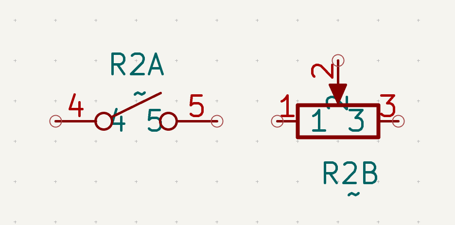

I don’t actually want to have the pot and switch as one symbol with the parts placed together and joined by a dotted line. I’d rather treat them as a dual op amp, where the two opamps are placed first then the power pins are placed as a third part. All separate on the schematic, numbered as a, b and c parts of the same ref des - but all three are obviously in one package on the pcb.
i.e. I want the pot as part a and the switch as part b.
Well that is going to make a mess of your BOM . . . .
Why is what I’m asking any different to a multi gate ic or a dual pot. They appear as one item in a BOM, don’t they?
Sorry I mis-read your post, I thought you meant separate symbols . . .
I’ve not created multi unit symbols so I have no first hand experience, but It may work, you have the option to mark them as Not interchangeable and perhaps you will need to make one of then, maybe the pot, a power symbol . . .
Just had a play . . . you can do it.

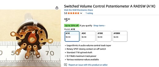

I can’t say how many of these/similar On-Off/Pots I’ve used since 1955 (when I started taking apart Radio’s and TV’s…)
I suspect they’re pretty-much arcaic these days but, still available…
Some were fully-enclosed, others open and can see the Spring-Beam.
For a Symbol, just use a Switch and Pot (or variable resistor and Switch, as posted above).
This is available at Amazon…
