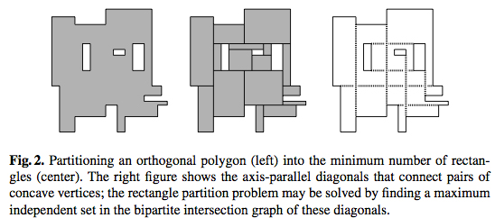

I had a short stroll on google thoughā€¦
Graphically they all talk about something like this (with/without holes makes a difference and also what kind of specifications the rectangles need to have)ā€¦
If I find some free time I might actually try this, but donā€™t hold your breath please.
No really, donā€™t hold your breath.
I implemented the idea of substituting polygons by as much rectangular pads as needed to cover the same area. I gave them the number 3 and added a pin on its schematic symbol. Then, I connected pin 3 to GND and regenerated the netlist file.
