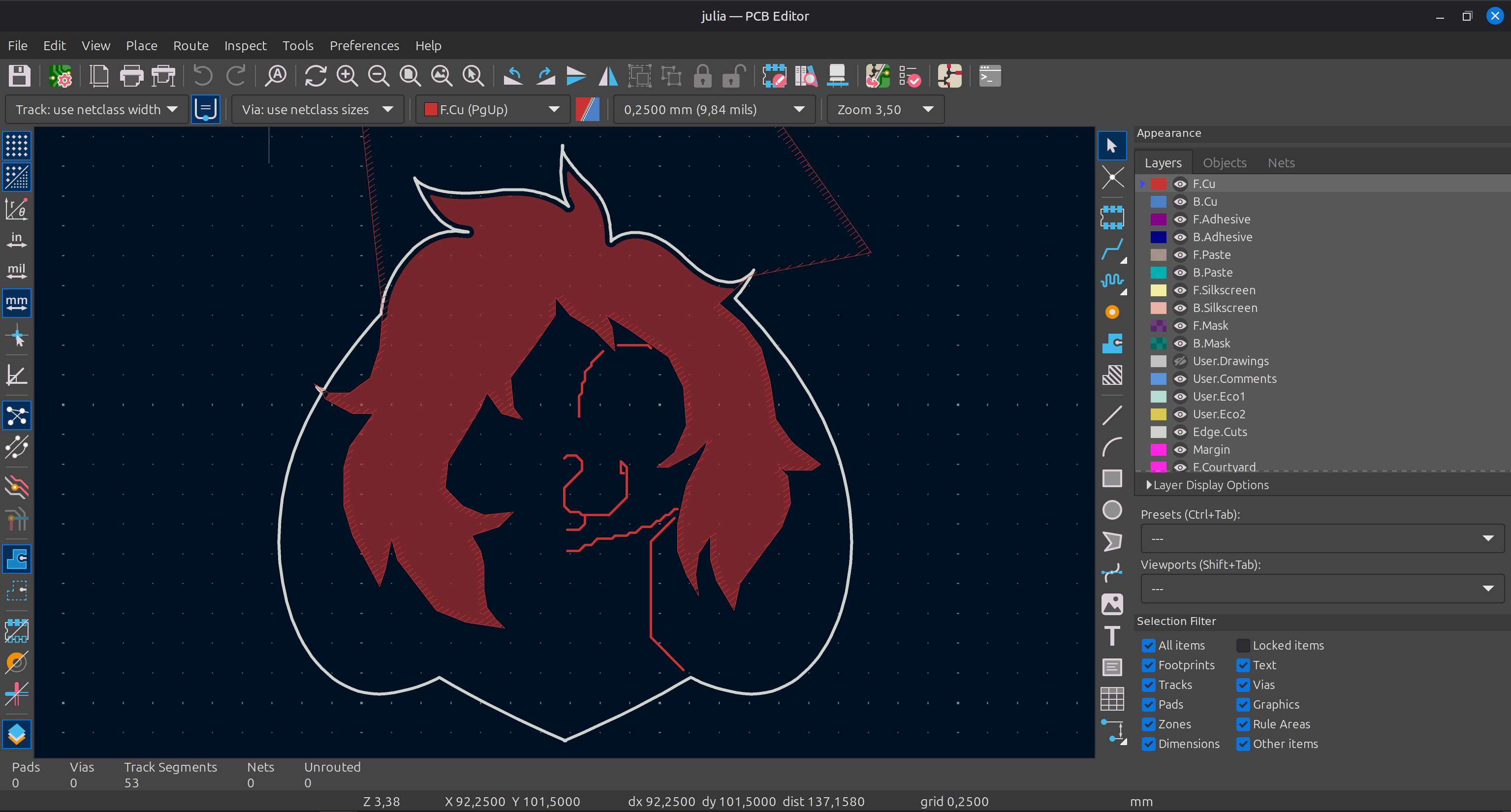

My issue is that my plugins seem to have vanished from the usual menu bar in the PCB viewer, as seen in the first photo (these popped up besides the terminal icon earlier).

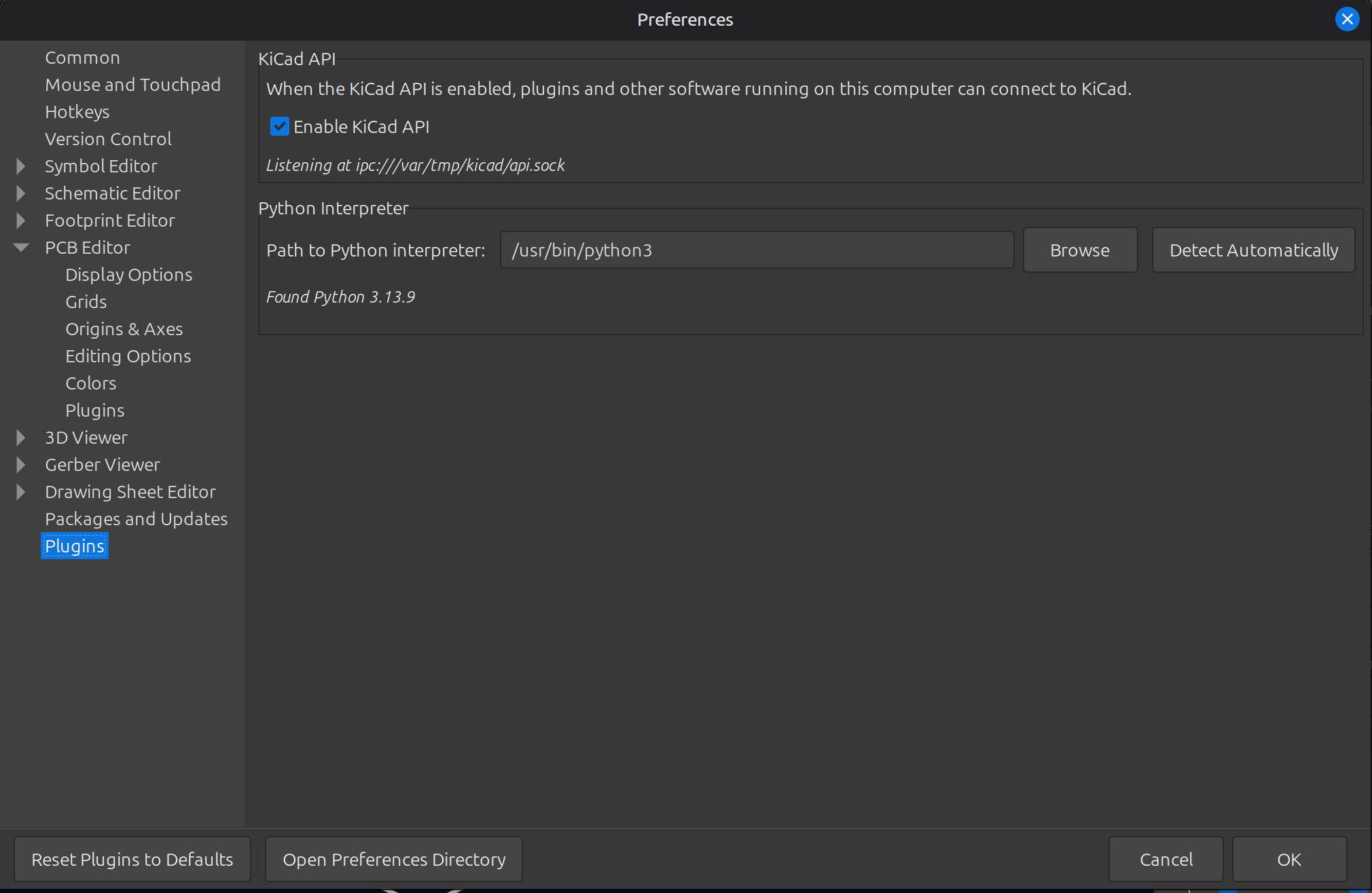

I have seen people suggest looking at the error message in the triangle icon (yellow) that pops up in Preferences > PCB Editor > Plugins, but this window is absolutely empty.
I have seen other people recommend installing requests for python, which I did by doing flatpak run --command=sh org.kicad.KiCad, then pip install requests. I saw someone else have the same issue but fix it with pip install kikit, but to luck sadly.
Preferences > Plugins looks like this

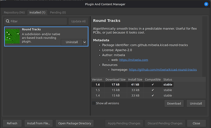

Proof I have a plugin installed:
I have uninstalled and installed it, without closing the program, so could do that, but feels like wishful thinking. Other solutions I’ve thought of is importing the plugins from “Install from File” but I would ideally like to fix the exact issue, not circumvent it. Same with someone else reverting to 9.0.5 that fixed it. I would rather have the issue solved should this impact future versions or be something that I can fix myself.

And please ignore the weird PCB thing I am working on haha, it’s an “art” project. Thanks for your help, I hope to get some insight on this.
