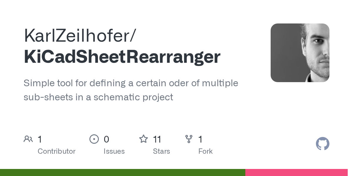

5.99 is using a completely new file format for schematics (and symbol libraries) that 5.1.x doesn’t know about. I just read on another thread that there is hope that 5.99 will become v6RC1 out in a month or two (the thread actually placed that date at the end of April, but I’m hedging my bets). Until then, check out this plugin:
I’ve never used it so I can’t testify to how well it works nor what horrible, schematic altering bugs it has. :wink:
Actually, not really a plugin as EESchema doesn’t have a scripting API yet. It’s more of an accessory program.

That plugin that I linked purports to do this but with a pretty interface. Again, I haven’t used it so I don’t know what if any bugs are in it. (I.e. make a backup before using it, like one should always do before using any untested tool.) Unfortunately, the repository doesn’t provide any binaries. Probably developed on a Linux system where it is perfectly reasonable to expect that a C++ compiling environment already exists (unlike MS Windows).
