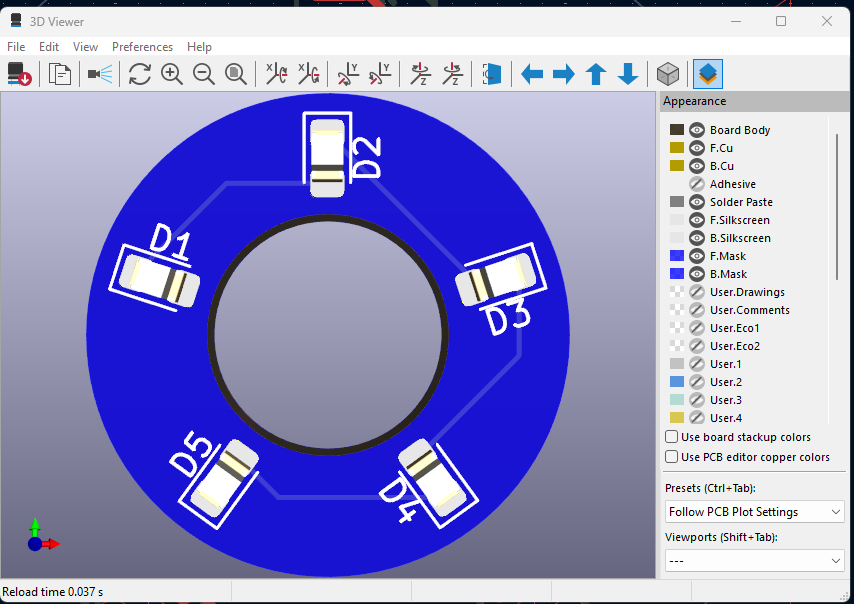

Need the 3D view to export a 3D file exactly as displayed
need the 3D view to export a 3D file exactly as displayed, or to export a skillscreen file that is the same size as the PCB design.
This allows the design to be used in other programs or incorporated into a model on a footprint.

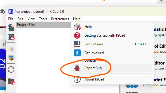

If you really do want to do a feature request you need to do it on the basis that you are using the latest version, you won’t get new features or even bug fixes for V8.x.y
And if you want to really do want to make a feature request you have to do it as a bug report from here:

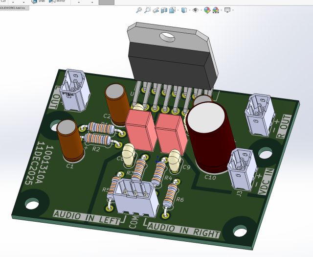

I do the following to get an image of the top (or bottom) of the PCB showing the silkscreen information onto the exported PCB STEP file:
  1. In the KiCad PCB Editor press ALT-3 to get the 3D image of the PCB.
  2. In the Appearance panel on the right, turn off (hide) all models.
  3. Zoom the image to fill as much of the screen as possible.
  4. Press ALT-[PRINT SCREEN] to take a screen shot.
  5. Paste that screen shot into the graphics editor of your choice (irfanview works well on Windows).
  6. Crop the image to the outline of the PCB and save it in the format that suits you.
  7. In whatever 3D CAD package you use, paste the image onto the top of the imported STEP file of the PCB and size it appropriately.
The resultant image looks like this is SolidWorks:

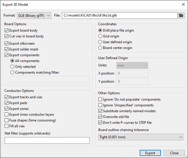

But like i said you can get silkscreen in 9 on the export. Then if we take a nonsensical board:
Image 1: a nonsensical board (9to3d.kicad_pcb (41.6 KB))
Okay so if we exprt this with following options as GLTF:
We get something very close.
So the red silkscreen is orange, sicce the overlay isn’t rendered the same.This is a bit disappointing since technically GLTF supports everything in the 3d viewer so its should accomplish this but alas different engines support different shading. Now we can change the color of the copper and have somewhat close to what the 3d viewer has but that’s a trick.

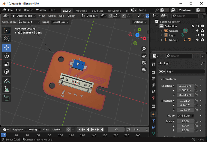

Same file in blender:
Ok so since renderers are different it will look a bit different, unsurprisingly.

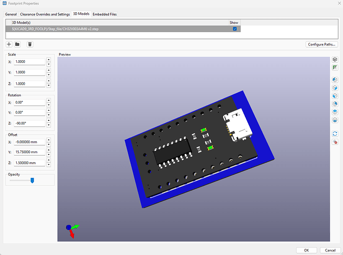

Okay so what about exporting to STEP. And then using it in footprint:
Pretty close same orange cast but very close. This could be fixed again by adjusting the copper color And again looks a bit different in different cads due to how their shading is designed.
So a bit of massaging to how the export does the mask layer is needed for more exact copy but you get it very close to what is there already. Files will be big though.
