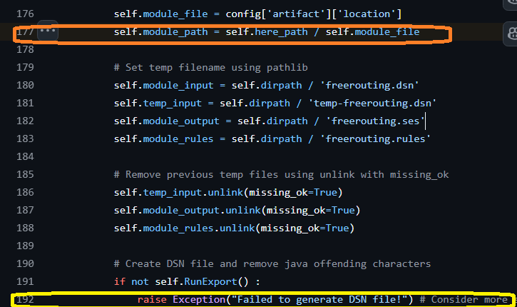

Ho bisogno di un aiutino, da qualche giorno non mi va piu’ il freerouting.
questo e quello che michiede ma non riesco a capire dove riparare il problrma.
grazie in anticipo a tutti!

When I look at the latest code for the plugin (6 months age)L177 now, it’s a completely different code.
https://github.com/freerouting/freerouting/blob/796c0c0088a10b4f4063368ddbd56ef398e0f0a3/integrations/KiCad/kicad-freerouting/plugins/plugin.py#L177
177: self.module_path = self.here_path / self.module_file
There are two possible reasons:
The plugin version is not the latest.
The KiCAD version is not the latest.
To confirm, please include Please include the version number of the environment in which the issue occurs.the KiCAD version and the plugin version.
