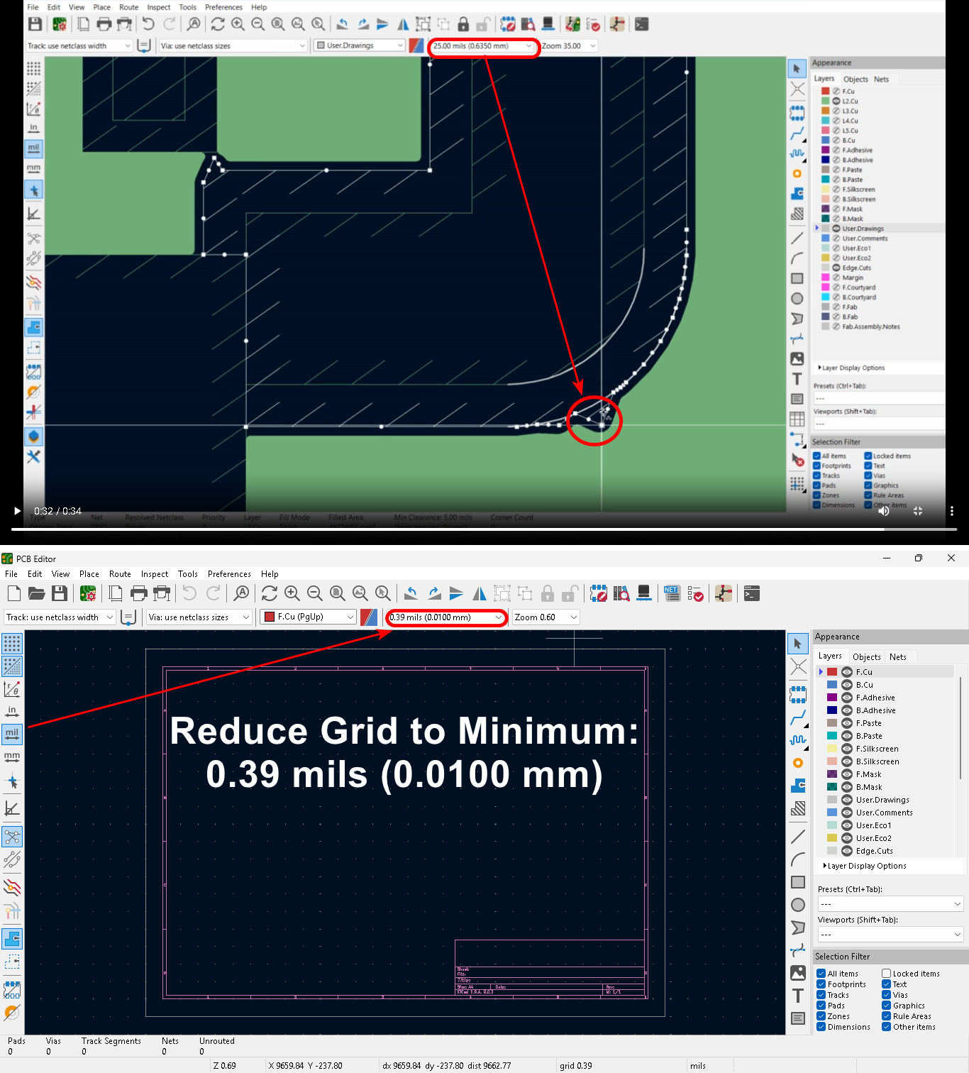

Try the 9.0.6 RC
If the grid setting is greater than the area of movement the program
may ‘snap by default’ to the size setting even with snap to grid off.
Try reducing the grid setting to minimum 0.39 mils (0.0100mm)
You can reset the grid as desired afterwards.
SEE IMAGE BELOW
As an alternative / workaround, you can also use the context menu to Remove Corner [Alt + C].
Hi folks,
Thanks for the suggestions - I do appreciate it. I will keep my eyes open for RC 9.0.6. In the meantime I just shrank the grid & positioned the points. I think that’s probably what I’ve done in the past as a work-around. Somehow I’ve always managed to get the points where I wanted them, but more than once it involved a lengthy trial-and-error session with the snap settings. Yesterday I finally had enough and thought, “I need to get to the bottom of this. What am I missing?!” :slight_smile:

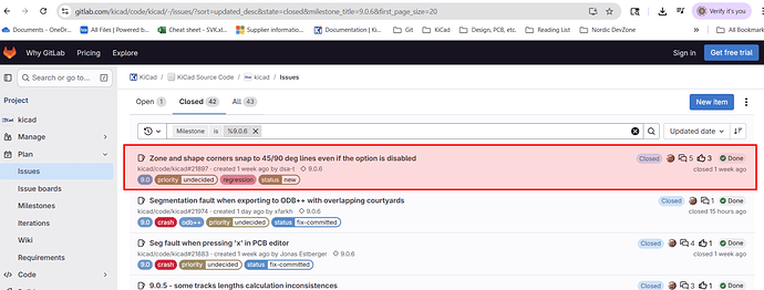

Thanks for pointing me to the release candidates. I had been looking in the wrong place. I was looking under the nightly builds & didn’t see anything with “rc” in the name.
I installed the 9.0.6 release candidate & now the snapping is working as expected.

FWIW, here’s what I found on the list of closed issues for RC 9.0.6

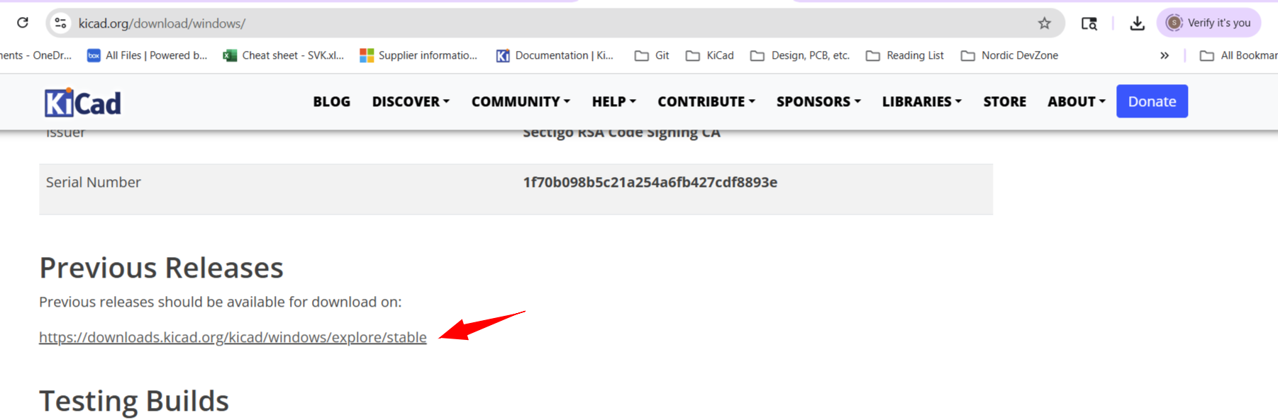

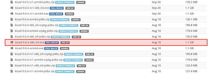

I went back to the release below (final 9.0.4 full build) & now the snapping appears to be operating normally. So far as I can tell, anyways.
For anyone who’s never gone back to a previous release, just go to kicad.org, click on Downloads –> Windows, & scroll down until you see “Previous releases”. I’m assuming it’s similar for Mac & Linux.
Hope this helps. For now I’ll be parked at 9.0.4. :slightly_smiling_face:
