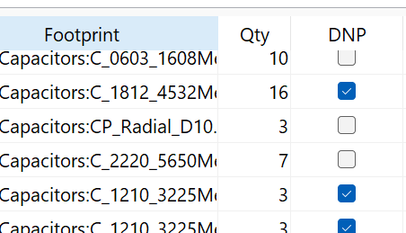

HI All,
Very often, a project involves many components, but then when the board goes into production, not everything is assembled. Many different versions are made with the same PCB; this is almost standard practice. Now, how do I do it? I manually mark the components that don’t need to be assembled in the BOM and also in the PCB, so that the 3D version only shows the assembled component. I was wondering if KICAD can manage, starting from the schematic, the components that need to be assembled version by version (DNP only allows for one…), to automate a process that I currently do manually by correcting and/or turning off the unassembled component.
THANKS

If you have it as two lines in BOM (from Eschema → Tools → Generate BOM, then select Edit tab), for example R1, R4, R10 - 0-ohm populate and R20, R40 - 0-ohm, DNP) then in right part of the window in DNP column you can tick / untick the whole line:

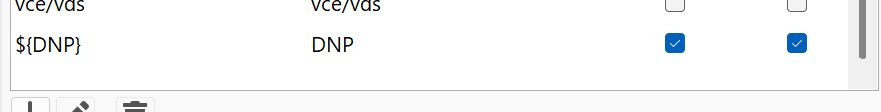

Make sure that DNP column is active in the left part of the window:
In 3D viewer I believe you can hide DNP components.
I think this is the key thing here, I’m pretty sure the OP is talking about Variants.
