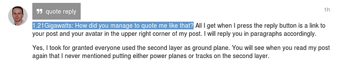

1.21Gigawatts: How did you manage to quote me like that? All I get when I press the reply button is a link to your post and your avatar in the upper right corner of my post. I will reply you in paragraphs accordingly.

Mark (or is it select? I don’t know the correct english word) the text you want to quote. A quote reply button gets shown.
It should look like this.
