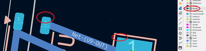

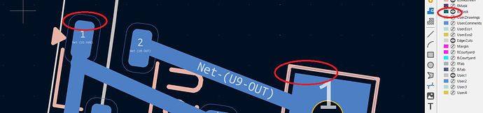

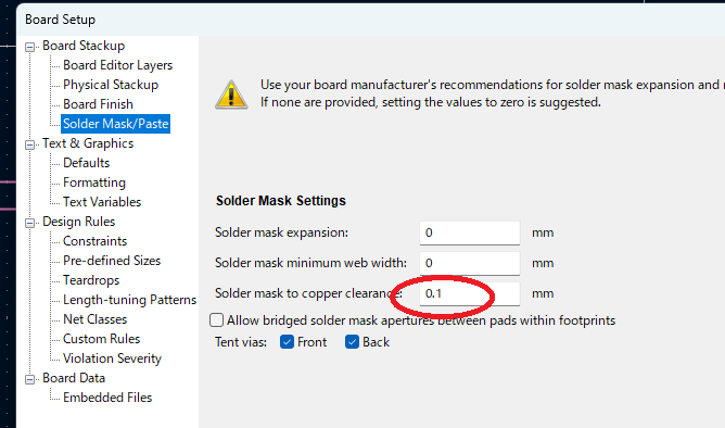

I have changed the clearance at Board Setup. But the design have remained.
I’m using Ver.9.0.4.

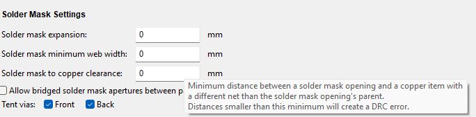

Your changed value does not change the design: read the popup help message if you hover the cursor over the edit field: this value is only relevant for the DRC.

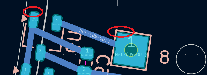

I don’t know what you want to achieve, but you may try to change the “solder mask expansion” value.

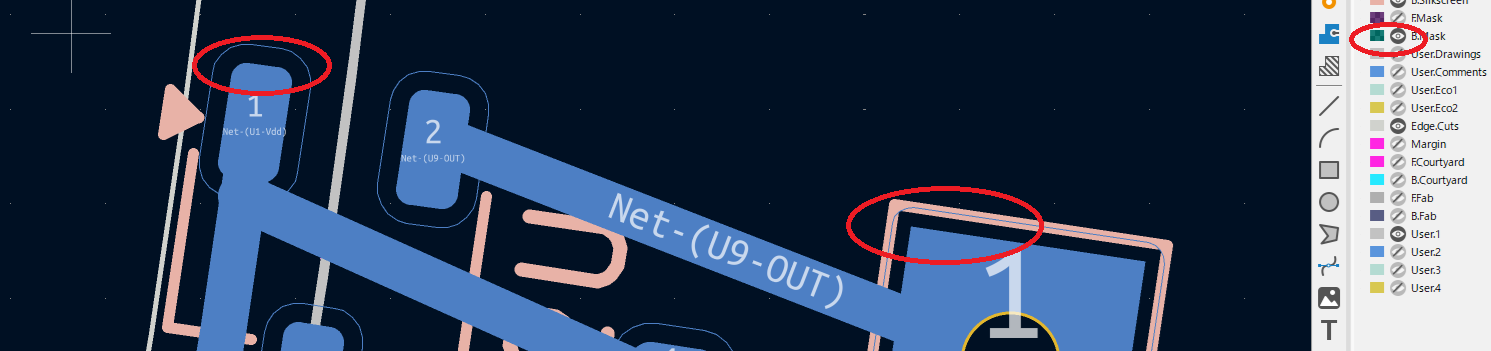

I could add clearance of register mask around copper using “Solder mask expansions” menu.
