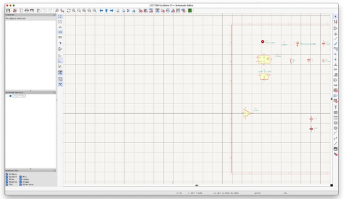

Not sure how to collect a video. Let me try to explain. Running the Schematic Editor, the screen size of my drawing sheet is 30x22cm including the documentation block in the lower-right-hand corner. The smallest movement I can make with the scrollbars moves the sheet 18cm on the screen.

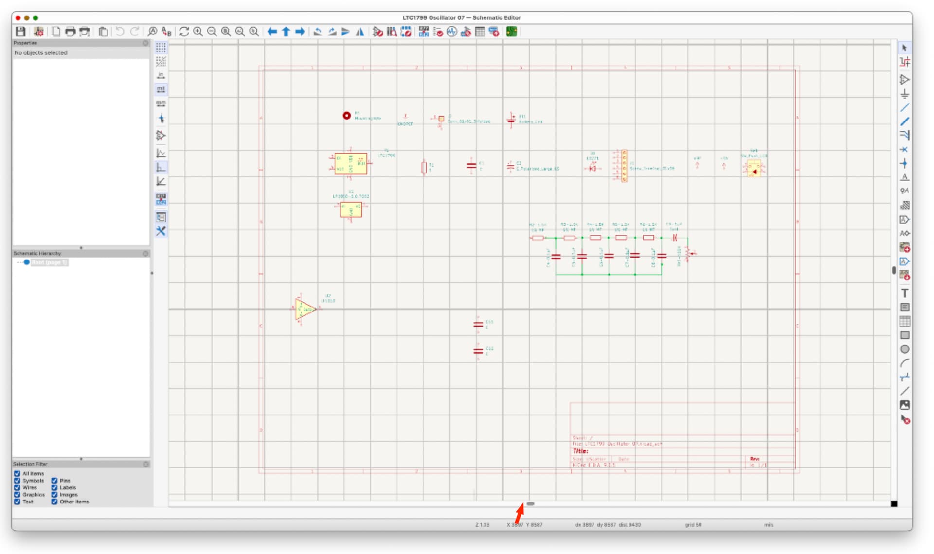

https://forum.kicad.info/t/exporting-a-high-quality-image-of-the-schematic/47647Screen Shot of KiCad Window 1See if these screen shots help.
No. 1 shows the KiCad window with my schematic. Note the red arrow at the bottom, that represents my cursor. I placed that there since screen shots do not capture the position of my cursor. No. 2 shows the window after I clicked once when my cursor was positioned as shown by the red arrow. Note how far the schematic moved. That is the minimum change I can obtain.

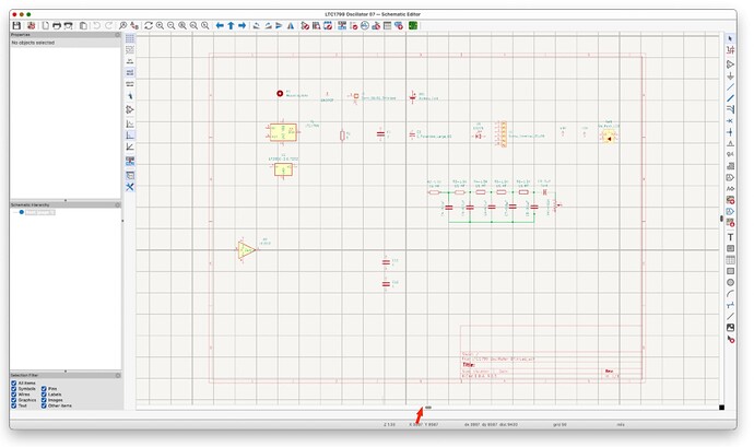

OK, that works. These screen shots refer back to my post on 10-11-25.

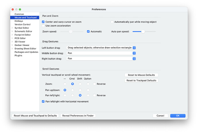

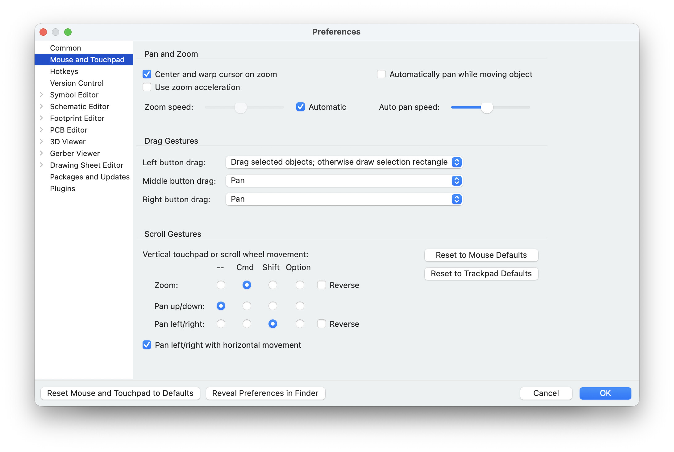

I’m glad you found v8 satisfactory. In case it helps, there was a moment in time when KiCad’s mouse/trackpad panning suddenly became really, really good on macOS, and I’ve never looked back. Here’s my current settings. I think from memory the key is the ā€œhorizontal movementā€ setting - I never use the modifier keys. I now exclusively pan with the Magic Mouse or trackpad, and zoom in and out with hotkeys assigned to ā€˜1’ and ā€˜2’.
Panning and zooming is so fundamental to enjoyment of an EDA tool, I can understand your frustration!
