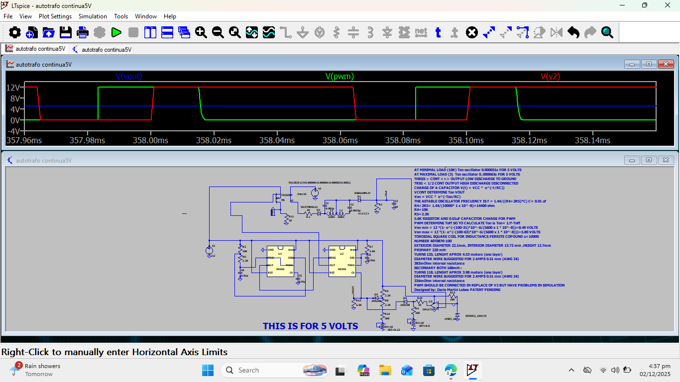

In Ltspice all parts can be simulated. When I join them together don’t simulate and LTspice personnel told me that gonna try to improve the library.

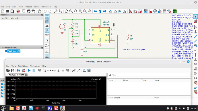

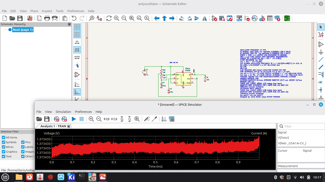

Here you have the oscillator. The only library is the one for the NE555 the rest are raw ngs standard resistors and capacitor.
onlyoscillator.zip (6.6 KB)
This is the screenshoot of the simulation

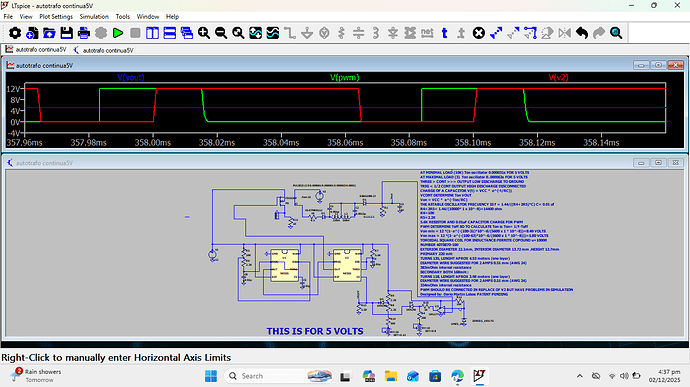

And this is the complete simulation in LTspice. It have a ground in the op to check minimum voltage. The PWM only works in two pulse width maximun current at this voltaga and minimum current as far as can work the op. since op is quite faster than 10khz in just one cycle can pass from low to high pulse width regulating the voltage in any condition between these two limits or living in top or minimun. Since NE556 is cheap is a convenient voltage current regulator,

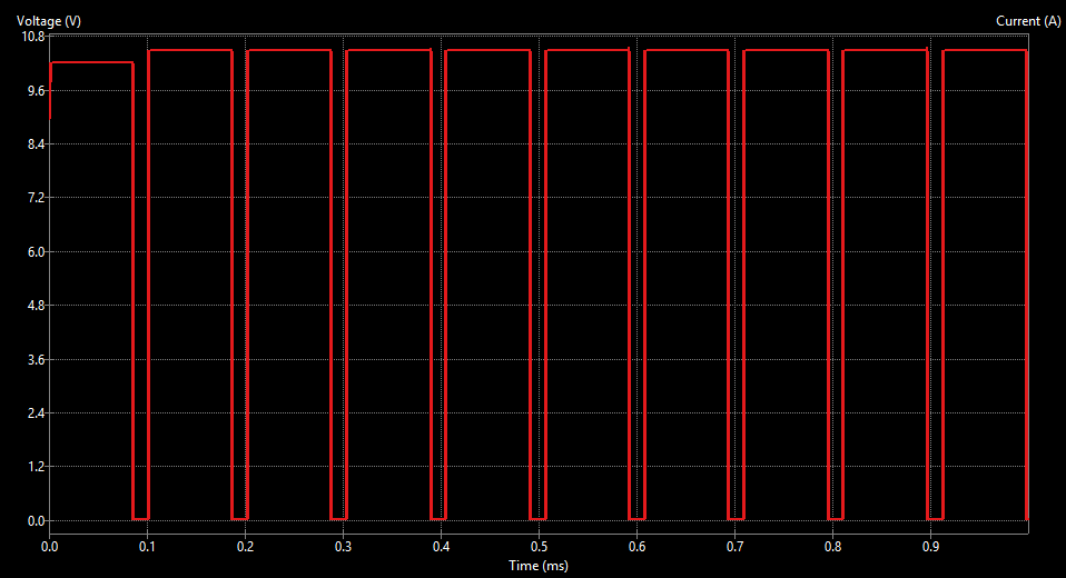

Did you do the correct pin assignment?
This is what I get with DarioLoblos.zip (7.3 KB):

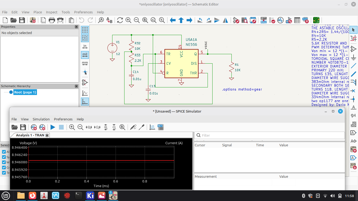

I downloaded the zip file that you attached, which is the same as I sent you, but for any case i checked that and i plotted with no results. What cab be? Mi computer is linux mint 22.2 not windows. and Kicad is 9.0
What is your time base?
Sometimes oscillators need some “kick” or initial condition to start oscillating. I have made this available in the project attached. DarioLoblos.zip (9.4 KB)

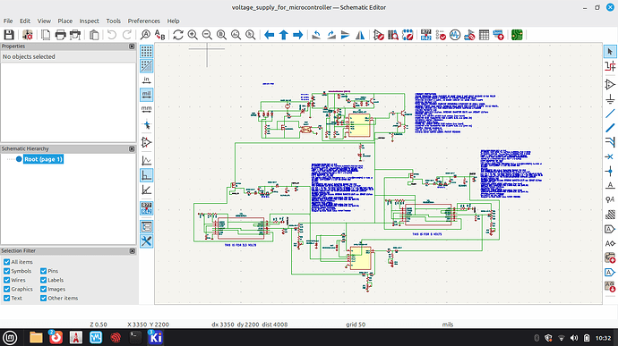

My upload is not the same as your example posted above. Especially it takes into account that a pin assignment is necessary when you want to do a simulation. When in your original project you are using a 556 symbol with 2 oscillators in a single package, this become even more important. Symbol pin numbers and model node names/numbers often are different, as KiCad draws its pin numbers from the device’s footprint. Other simulator don’t care, as they don’t use footprints.
You may find some information here: KiCad Eeschema as GUI for ngspice, tutorial for setting up the simulation .

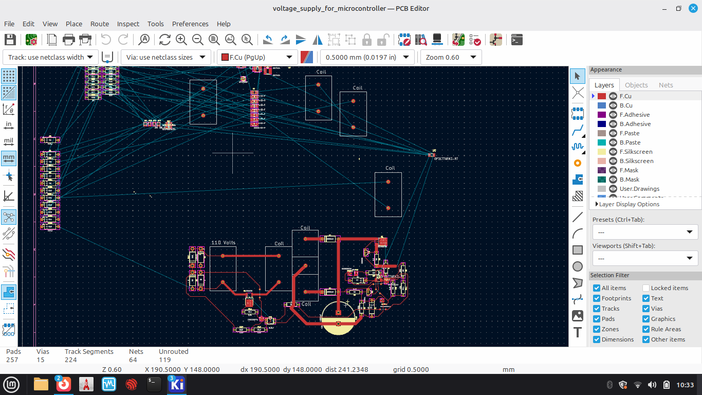

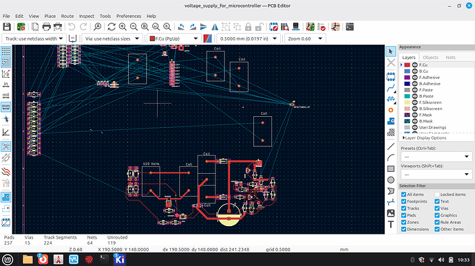

Thanks I will check during this day, I will download this and check it right now. I changed some symbols to can do the PCB. I think that new symbols are correct pin assigments. I will revise all with the datasheets. Attached are the new symbols complete circuit and the starting of the PCB. PCB module is very good I am very glad with I and giving thanks. Is a circuit hand welded with resistors THT 1/4w. I use them in some cases as bridges or vias.
I will tell what about simulation soon. Many thanks in advance.
Many thanks THE SIMULATION THAT YOU SENT ME WORKS SO I WILL CHANGE MY PROJECT USING IT AS SAMPLE.
