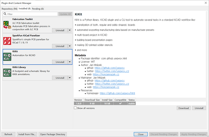

It looks like the plugin manager in Kicad will only install version 1.6 of Kikit. How can I manually install the latest version, 1.7.2?

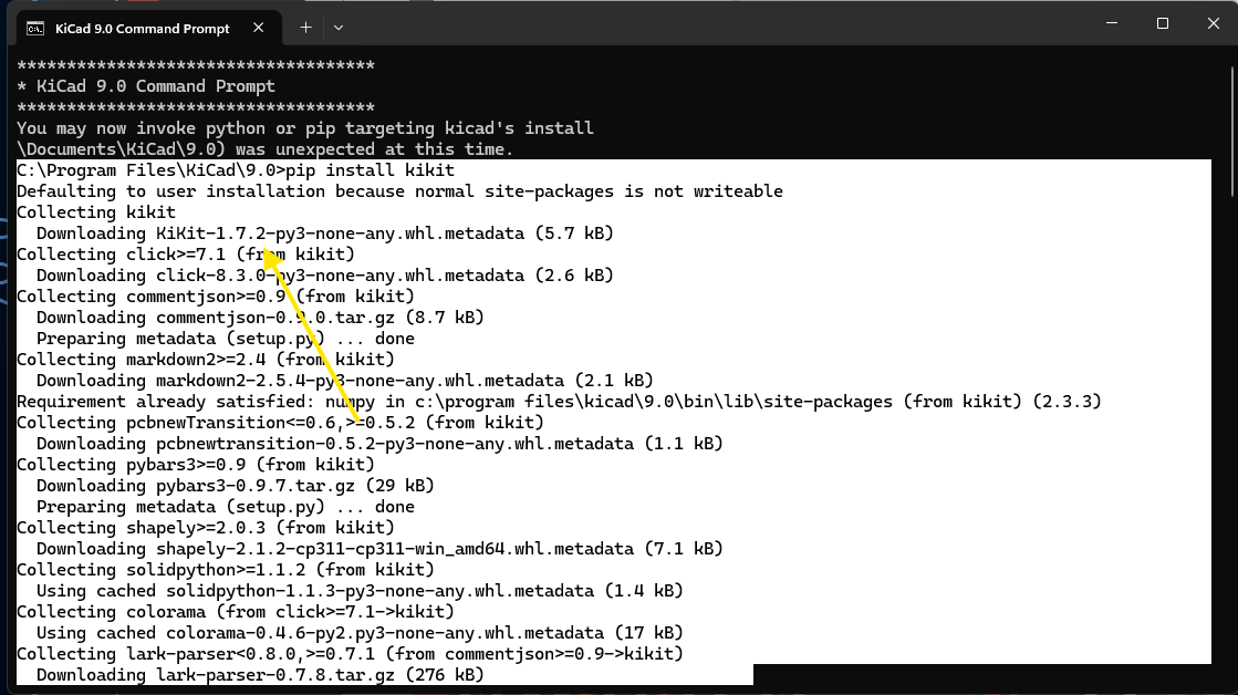

I went there and followed the instructions. After running ‘pip install kikit’, I run kikit –help it bombs with an exception.
ImportError: DLL load failed while importing _pcbnew: The specified module could not be found.

You probably installed KiKit via Windows command prompt, not KiCAD Command Prompt.
I installed using the Kicad command prompt.

Then you have to enter the following command to install it:
pip install kikit

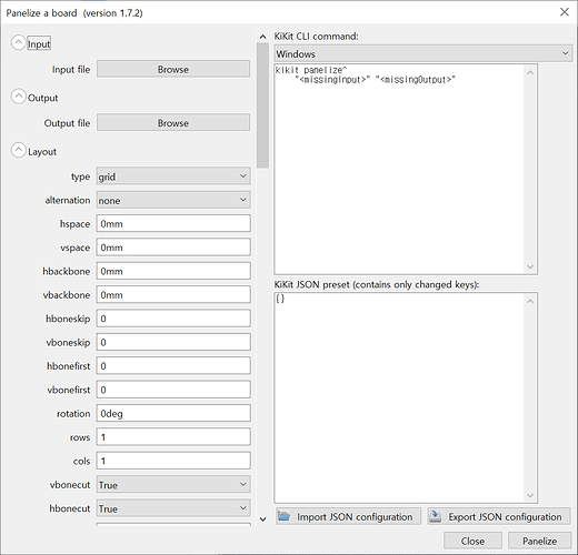

I’m showing the Kikit plugin in my KiCad 9.0.5.
However, when I try to panelize in the GUI, the program stops and freezes.
So, I just import the command script from the GUI and run it in the command prompt.

Then install the GUI etc from PCM.

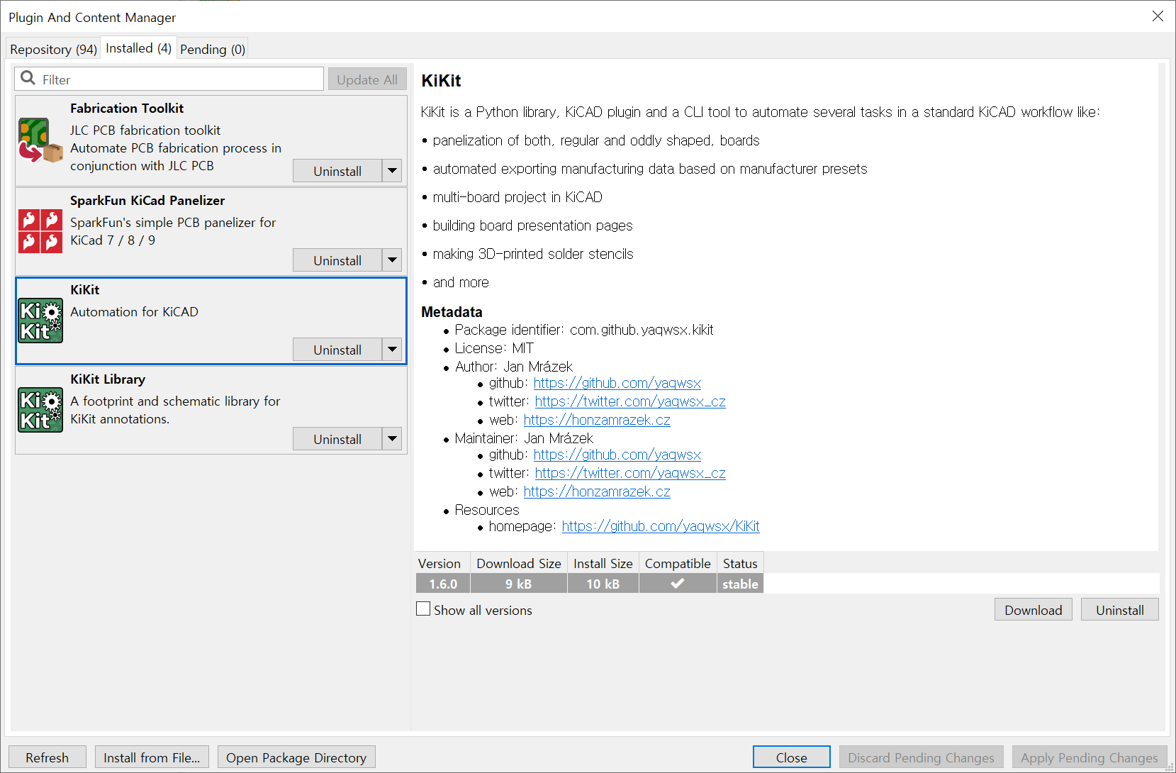

In My Plugin and Content Manager, it says KiKit 1.6, but when I run the plugin the title says Kikit 1.7.2.
