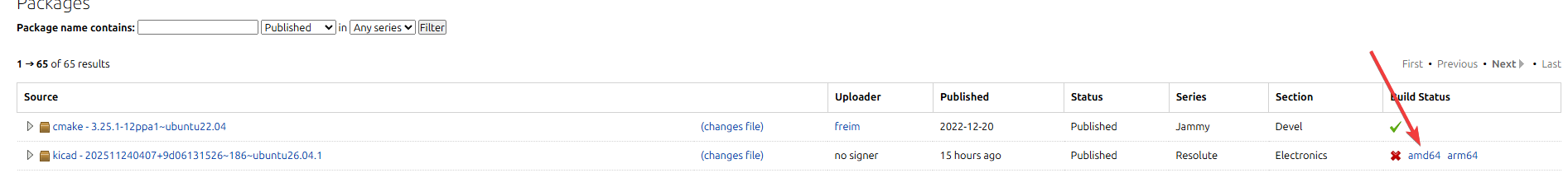

Btw, the latest kicad-nightly build for ubuntu 24.04 (the current LTS release) is nearly a month old. Am I missing something or is this build stuck?
Yes, same here. There is several issues in the current Nightly version, but I suspect that most of than could be already fixed.
If some dev give some direction of the farm compilation error, I could being following and help in the future.
This happens closer to the first release candidates usually.

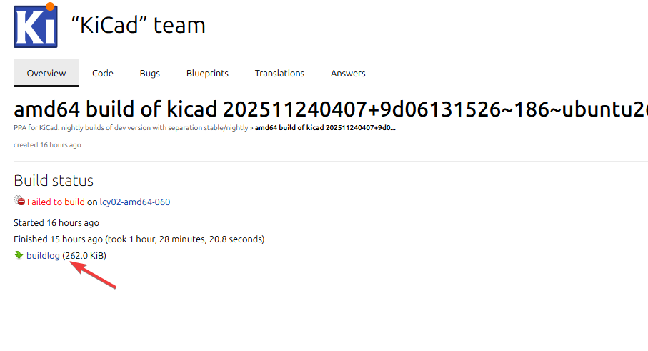

The PPA is built by launchpad, they do not allow remote uploads of packages. You can view the errors on there.
I applied a potential patch for it already.

Note, the problem isn’t in this repo/recipe. There is no missing dependency.
Instead its a link error due the SPICE qa test executable (not ngspice, but our own code) attempting to pull in pcb functions that isn’t correct in anyway. There was an errant link to a pcb library which I removed.
