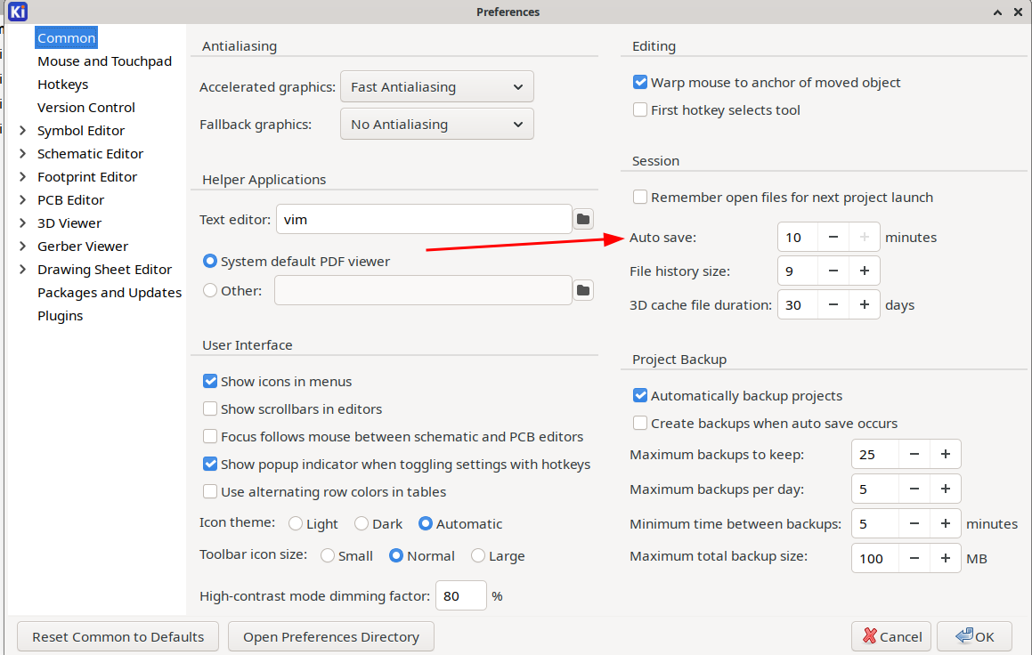

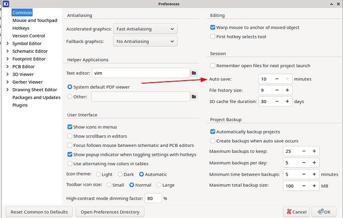

On my own system (quite small projects, saved to an local SSD) the auto-save is noticeable sometimes. I don’t know how much influence network speed has, and how much is computer hardware related. Zipping up a backup does need a bit of cpu time. In theory, part of this could be delegated to a separate thread, but I do not know whether KiCad does this.
One easy way to verify is to check the file date/time on the files on the NAS after such an event. You can change the interval or even disable auto-save completely in the preferences.

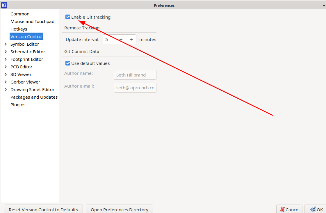

You can try a few things.
  1. Try disabling the autosave option in your preferences

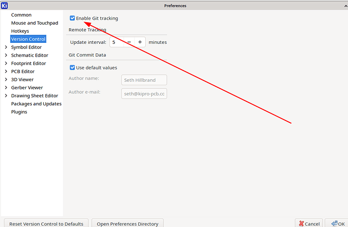

  2. Try disabling git
is it possible to specify where the autosave files are being stored? Maybe having the autosave local and the files in the remote server is a good option.

I encountered this problem for the first time yesterday – a complete lockup for more than 10 seconds for no apparent reason. After finding this discussion thread I realized that this was the first time I’d used KiCad 9 at a location where it couldn’t see my Git server. Unticking the “Enable Git tracking” preference appears to have resolved the problem.
Git is designed to be usable without connectivity to servers, and the local copy may have links to several different remotes. Expecting access to one (or several) remotes is broken.
Whatever KiCad is doing with Git needs to be fixed. Is there an open issue to track this bug?
