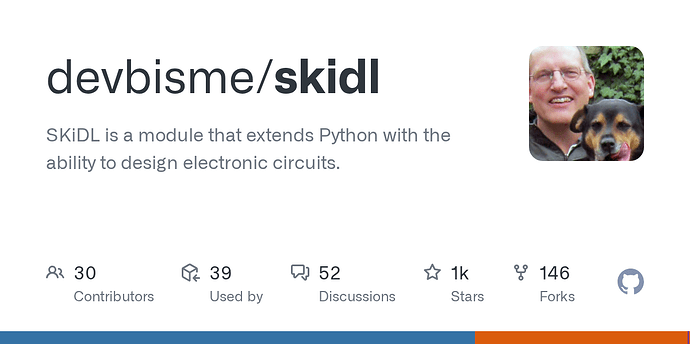

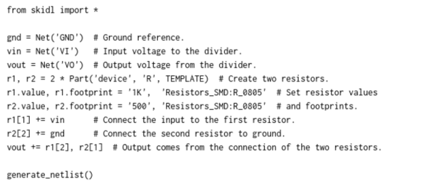

Are you aware of SKiDL?
SKiDL does not create a KiCad schematic, but creates a netlist that can be directly used in the PCB editor. I have always found this in intriguing project and useful for some schematic types (FPGA projects, or big button / led matrices), but for other sections (such as a power supply section) normal schematic entry is more suitable. I always felt that SKiDL would be more useful if it could be used as an addition to a project, so it could be combined with schematic entry.
