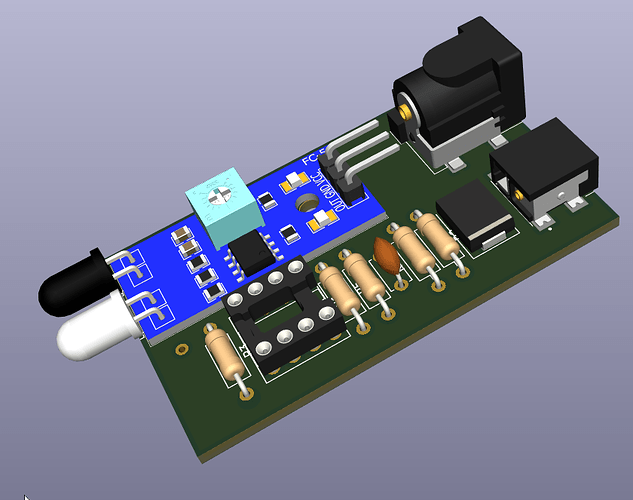

BTW: the design is very very simple: just a custom IR sensor component, two barrel power connectors, an ATtiny85 and a few passive components.. That’s it.
