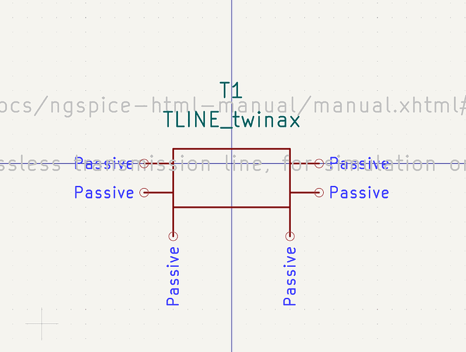

and the following symbol:
(kicad_symbol_lib
	(version 20241209)
	(generator "kicad_symbol_editor")
	(generator_version "9.0")
	(symbol "TLINE_twinax"
		(pin_numbers
			(hide yes)
		(pin_names
			(hide yes)
		(exclude_from_sim no)
		(in_bom no)
		(on_board no)
		(property "Reference" "T"
			(at 0 7.62 0)
			(effects
				(font
					(size 1.27 1.27)
		(property "Value" "TLINE_twinax"
			(at 0 5.08 0)
			(effects
				(font
					(size 1.27 1.27)
		(property "Footprint" ""
			(at 0 0 0)
			(effects
				(font
					(size 1.27 1.27)
				(hide yes)
		(property "Datasheet" "https://ngspice.sourceforge.io/docs/ngspice-html-manual/manual.xhtml#sec_Lossless_Transmission_Lines"
			(at 0 5.08 0)
			(effects
				(font
					(size 1.27 1.27)
				(hide yes)
		(property "Description" "Lossless transmission line, for simulation only"
			(at 0 0 0)
			(effects
				(font
					(size 1.27 1.27)
				(hide yes)
		(property "ki_keywords" "lossless transmission line characteristic impedance"
			(at 0 0 0)
			(effects
				(font
					(size 1.27 1.27)
				(hide yes)
		(symbol "TLINE_twinax_0_1"
			(rectangle
				(start -5.08 1.27)
				(end 5.08 -3.81)
				(stroke
					(width 0)
					(type default)
				(fill
					(type none)
		(symbol "TLINE_twinax_1_1"
			(pin passive line
				(at -7.62 0 0)
				(length 2.54)
				(name "NI1"
					(effects
						(font
							(size 1.27 1.27)
				(number "1"
					(effects
						(font
							(size 1.27 1.27)
			(pin passive line
				(at -7.62 -2.54 0)
				(length 2.54)
				(name "NI2"
					(effects
						(font
							(size 1.27 1.27)
				(number "2"
					(effects
						(font
							(size 1.27 1.27)
			(pin passive line
				(at -5.08 -6.35 90)
				(length 2.54)
				(name "GND1"
					(effects
						(font
							(size 1.27 1.27)
				(number "5"
					(effects
						(font
							(size 1.27 1.27)
			(pin passive line
				(at 5.08 -6.35 90)
				(length 2.54)
				(name "GND2"
					(effects
						(font
							(size 1.27 1.27)
				(number "6"
					(effects
						(font
							(size 1.27 1.27)
			(pin passive line
				(at 7.62 0 180)
				(length 2.54)
				(name "NO1"
					(effects
						(font
							(size 1.27 1.27)
				(number "3"
					(effects
						(font
							(size 1.27 1.27)
			(pin passive line
				(at 7.62 -2.54 180)
				(length 2.54)
				(name "NO2"
					(effects
						(font
							(size 1.27 1.27)
				(number "4"
					(effects
						(font
							(size 1.27 1.27)
		(embedded_fonts no)

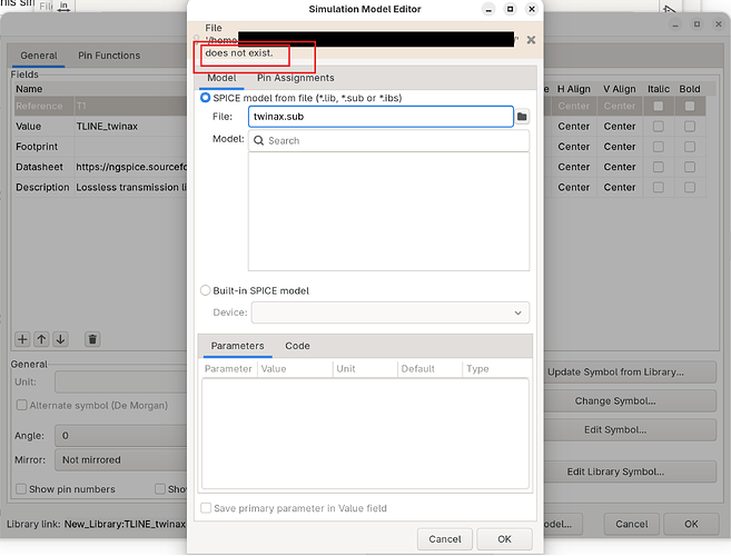

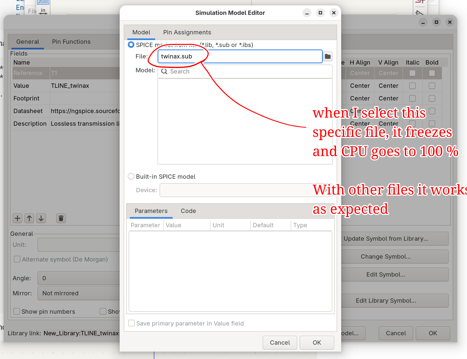

When I try to assign the simulation model it crashes when I select the file (see screenshot below). What happens is that KiCad freezes and one CPU core goes to 100 % usage. Only solution is killall kicad (I waited about 2 minutes).
Any ideas?
”dous not exist”. is “not a crash”, but if it is, I think you can find the cause more quickly by attaching the results of the crash dump.
No, that is not the problem I am having, that is the normal behavior when the file does not exist and it does what is expected. But when I choose that particular model I posted, it crashes.
Where is the crash dump located?
Please check & search keyword “Freedesktop crash dump”. It is not a KiCAD issue but a Freedesktop community topic. Normally, if you set the environment variable and start KiCAD, the crash dump size limiter of 0 will be released and a crash dump file should be generated.

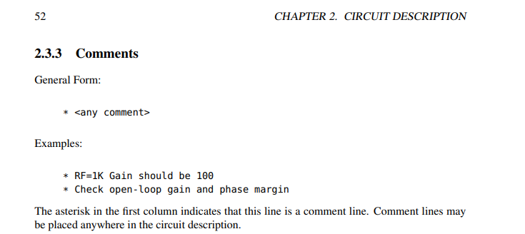

  2. If I modify it to
    .subckt twinax a b c d e f
    R1 a d 100
    R2 b e 100
    .ends
    it works as expected.
Is * a valid comment line and ; a specific Dialects provided by specific vendors.
