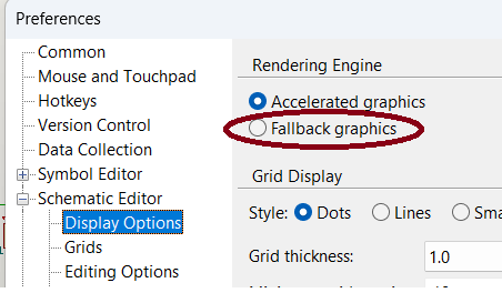

KiCAD 9.0.3 Hanging on Schematic Open
The schematic editor has the same. You’ll be the one who need to try it to see if it relates. Or not.
Thanks, I’ve changed both settings and will report back if I continue to see issues.

Okay, In my case, I was trying kiri git diff tool that generated tons of file that kicad seems to have trouble processing, I deleted the generated folder ./.kiri from the project repo, and voila it solved the lag issue.
I haven’t had any new hanging events on open after changing the display options to fallback graphics, so it seems like this really might be it.

This seems very much like an issue in your graphics driver.
