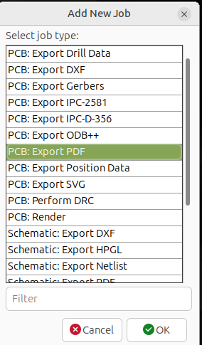

you can export both .pdf and .svg files of the pcb as well as 3d rendering using jobsets:

For every project I have a set of commands that I run to generate Gerbers, BOM, PDFs etc. using python and the kicad-cli. As an example this is my command for generating a PDF of the PCB placement:
kicad-cli.exe pcb export pdf --output <your output_file> --layers Edge.Cuts,F.Fab,F.Silkscreen --include-border-title --crossout-DNP-footprints-on-fab-layers --drill-shape-opt 0 --mode-single <your input_file>
Here is information about all the options:
KiCad Command-Line Interface | master | English | Documentation | KiCad

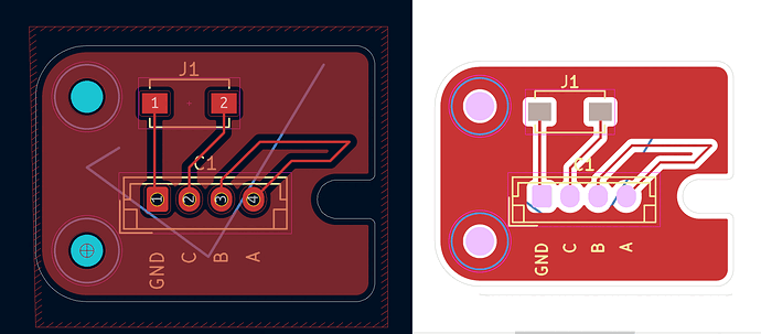

Yes i am aware that i can export a PDF and SVG but it odes not look as informative as a screenshot I also would want to see the pad numbers, zone polygons, have similar transparency on layers etc. I don’t want fabrication outputs as such. just closer to what it looks like on screen.
But if you can guide me how i can get the default PDF looking closer to whats on screen then I am all ears.

I can screen capture in python. But how do i move the view port to a saved location with pyhon?
See the image on the left is more informative than image on the right Because i can see through the board, so i can see bottom layer etc
