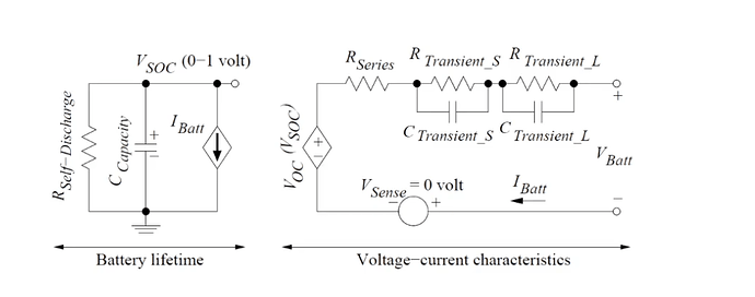

Modeling batteries is somewhat complex and still done by researchers. A recent article is this (google ‘spice model for battery’): https://www.mdpi.com/1996-1073/18/17/4709 .
