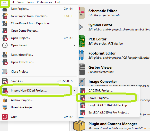

Hi Troels,
I have imported many eagle projects to KiCad and have successfully brought them to manufacture, assembly and function. So, I completely understand your struggle.
FYI, I have and had KiCad 9.0.2 installed.
After following the image, I always choose pcb file of eagle (.brd) when importing. After choosing your brd file, you are asked to select a folder for your imported project (kicad) to be saved in.
Then you must see the window “Edit mapping of imported Layers”. I always do this:
I first do “Auto-Match Layers” and then I match every layer that is left to a user layer. Because as far as I know, once importing is done, you have no longer the chance to retrieve any missing layer. Yes, you can import again. But definitely you’ll lose your edits.
I then take screenshots or notes that which layers are connected to which user layers, then if later needed, I activate the required user layer. In this way I never lose/miss layers again.
Here comes the important part: You have to save both imported schematic and imported pcb. My suggestion is to first save and then close everything and open them again.
Then hit Switch to PCB Editor in schematics, and vice-versa in PCB to make sure they are bonded with each other.
Also, in order to see the library that kicad has converted from eagle for you: from project manager, go to footprint editor, a library, sharing same name with your project, consisting all converted footprints, must exist there.
Or
simply go to PCB, select one footprint, open its properties (hit E or double click), then “Edit Footprint…”, then on the upper part of the window you see a yellow bar, click on the blue linked-like text “Open in library {your_project_name}”, when you click on that, you open the footprint in the library imported from your eagle project. On the left side you can see your other footprints.
I hope these could solve your issue.
Mahsa
