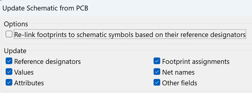

I want to place components (not footprints) on the PCB, then update the schematic from that. Is this possible?
I’d like to document/reverse engineer an existing PCB.
I would like to do this:
  1. place components on the kicad PCB like they are on the real PCB, give them the correct name (like R45 or Q3). This is impossible, I see only place→footprint in pcbnew
  2. Draw traces on the kicad PCB like they are on the real PCB. This works, I can do route→route single track in pcbnew
  3. Give the traces names like GND or 5V, or J3Pin4Input. In pcbnew I can double click on a new trace, and assign it to a net. I would like to create a new net for the trace I just drawn in step 2, but I can’t find where I can do that.
  4. Create/update a schematic from the pcb. This doesn’t work, as the PCB doesn’t have the information what components are present on the board, it only knows the footprint. So I get the message: “Warning: Footprint ‘REF**’ has no assigned symbol.“, and the schematic stays empty.
The “name” is Reference, i.e. reference designator, by default it’s REF**. Just change it in the Properties of the placed footprint.
The nets can be managed in View → Panels → Net Inspector. On that, context menu → Add Net.
Updating the schematic from the PCB works if you already have the schematic and the symbols in it, and updating is limited in certain ways. KiCad can’t read your mind to know what symbol each footprint needs. In the normal workflow you add symbols first and define the footprints for them in the symbol properties. Then KiCad knows what footprints must be added to the board for each symbol. The same doesn’t work in the other way: you can’t add a symbol to a footprint.

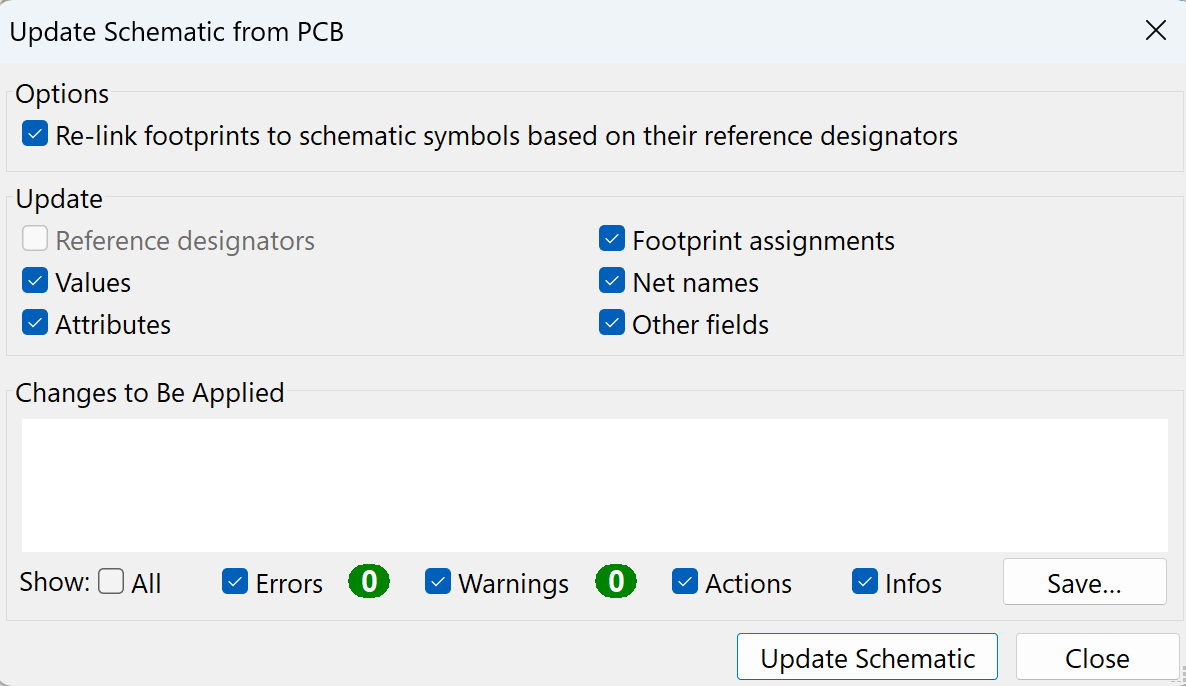

So, you have two possibilities:
  1. After doing the PCB, add the corresponding symbols to the schematic and give them the correct reference designators. Then update the schematic from the PCB, using the option to use the reference designators:

2. Because you are going to have the schematic anyway, why not to start with the schematic? You know all the components and what they are, so add the symbols to the schematic, choose the footprints for them in each symbol’s Properties and update the PCB normally from the schematic. If it’s easier to reverse engineer the connections in the PCB, continue by adding the nets and tracks in the PCB, then do the backannotation to the schematic, but without using the reference designators:

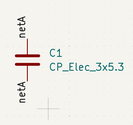

In any case KiCad can’t automatically draw wires in the schematic, but with backannotation you should be able to add the labels to symbols.
Here’s a very simple example where I added a symbol to the schematic, changed its reference designator (C1) according to the PCB where I had put the footprint with Reference C1, added a net and changed the net of both pins. After KiCad has updated the schematic there are the net labels in the pins. Now you can move the symbols (with the labels) and wire the schematic.
