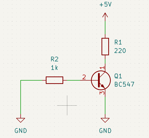

I am new to Kicad, I would like to know how to simulate in KiCad
Cause I have some trouble simulating transistors and diodes
  1. Have you looked at this document for ngspice (instead of KiCAD document)?
    Tutorial: ngspice simulation in KiCad/Eeschema
  2. Are you looking for something about BC547?
    Have you set up a model for simulation as described in 1.?
    KiCad ngspice does not provide these special device models with their distribution, you have to look for it elsewhere, e.g. at our Models for ngspice page,
  3. models_ugr\modelos_subckt\spice_complete\BJTN.LIB In this file
    .MODEL BC547 ….

This thread may help.
It is not in this circuit but I have the same issue with diodes
What only you can see, only you can solve. I think you’d be happier if you told other people what you’re seeing, but what do you want to know?
Thank you very much tama !!.
In the FAQ article linked to by amit, I collected some resources that help with getting started with simulations in KiCad. I suggest that you start with some simple things, such as downloading a few of the examples and verify they work. Then you can start modifying them, and do things such as substituting your own diodes and BJT’s.
