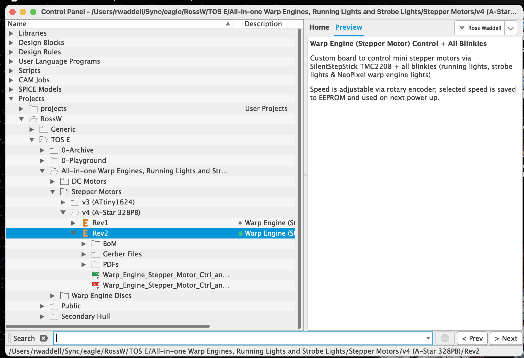

I plan on migrating to KiCad next year when Autodesk suspends support for Eagle 9.6.2, but I can’t figure out how to replicate my folder structure that I have:
I need to organize my projects by: NAME (e.g. All-in-one Warp Engines), VERSION (e.g. v4), REVISION (e.g. Rev2). Is that possible in KiCad?

I think his point is EAGLE’s main window here was more of a file explorer, you could open as many PCB designs you want there.
KiCad does not function like that.
To duplicate your Eagle arrangement using Kicad, I believe all your folders and sub folders from your initial “Projects” up to and including “v3” & “v4” will need to be created with your Operating System.
You would then place three different Kicad projects, ie. “A-Star 328P8”, “Rev1”, & “Rev2” in the “v4” folder.

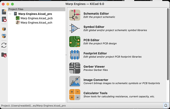

Thanks jmk, but while I can create the desired folder structure in my OS I can’t differentiate them (“v1/rev1”, for example) in the KiCad UI.

As @marekr states, Kicad doesn’t work that way. Kicad only produces projects, not project file structures. You need to use your OS to select any project.

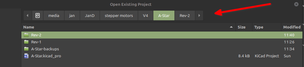

I’m not sure how Windows works, but in Ubuntu, when you open Kicad and use File > Open Project, you get the below result:

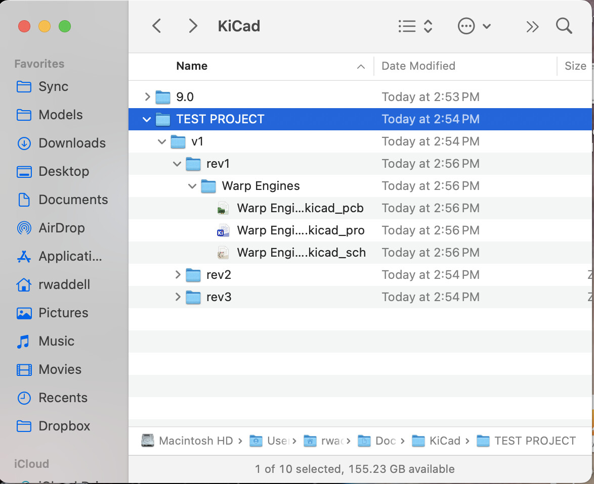

Yes, organizing your projects in such a way is possible. But you won’t see this structure in the kicad project manager (the project manager is not a fully fledged file browser) and sometimes you will have to prepare this directory structure with the file manager from your OS.
I would recommend this workflow (you should try, if that suits you):
  • use file system browser to create folders:
    • warp
      • dc motors
      • stepper motors
      • v3
  • create kicad project stepper_v3_Rev1
  • work with that project
  • if you are ready to evolve to the next version:
  • kicad main manager–>File–>SaveAs and save into new subdirectory stepper_v3_Rev2 (or stepper_v4_Rev1)
In contrast to eagle you will have to use the OS file manager sometimes, but the principle folder structure can be similar to eagle (I made the transition 5 years ago, and I have a similar structure)
So, is it that in KiCad you only see the current project you’re working on? If so, that explains what I was seeing and how the solutions provided here will work just fine.
