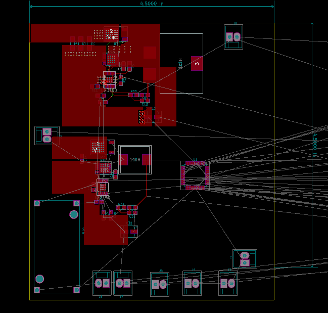

Hey all, I am trying to make a PCB design, and realized that I have been adding a bunch of different copper pours (for thermal considerations), and there is a lot of empty zones that would typically be filled with a copper pour along the outside of the entire board. I was just wondering if it was possible to make a layer have default net, or do I have to add the copper pours myself for the complex geometries that my creation of copper islands has done.
The PCB i posted below is what I am talking about. For me to fill in the entire layer by adding copper pours would be difficult right?
you can add one large copper pour with the net of your choice but lower priority then the other copper zones within it.
Ohhh, thank you so much!
