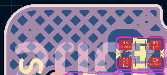

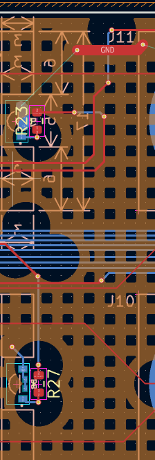

This is what I get when I enable hatching in the zone settings,
but I want a pattern like the one shown
. Is there any way to achieve that?

It should be possible in the future, in v10.
This is already possible in v9, its on the right of the zone properties box.
KiCad V8 has the same options in the same dialog.
And if you look at the v6 and v7 docs, the orientation option is already there. Therefore, RTFD.
