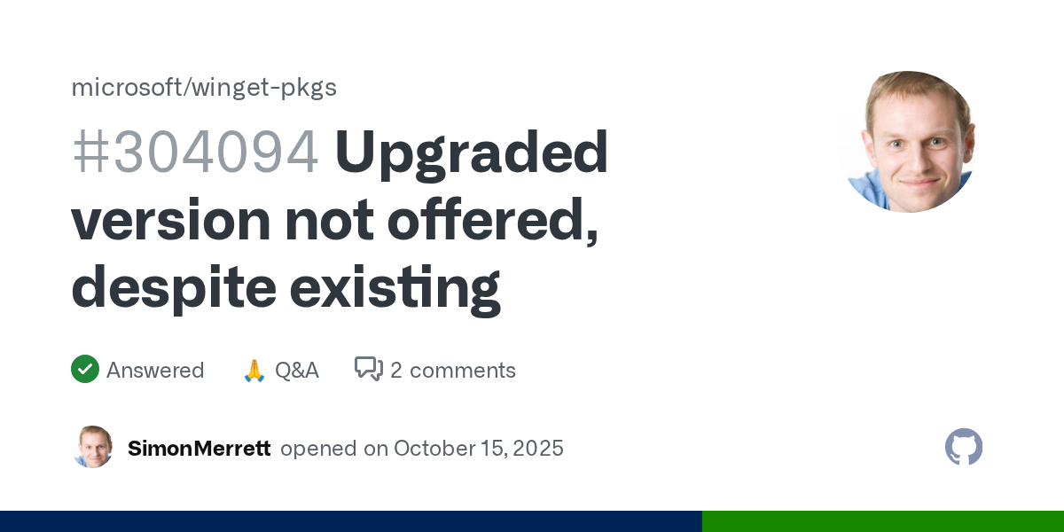

microsoft/winget-pkgs · Discussions · GitHub
I understand that it isn’t and shouldn’t be the main package distribution channel, but it is convenient when I have to switch machines more frequently than I would like and winget allows some scripts to get the new build machine close to how I had the previous one. Thanks for the steer to winget team.
So I asked the winget people about this. They point out that it is KiCad versioning that is breaking the expected behaviour here - effectively x.99 is higher than x.0.x, so if you have a nightly installed, you will never be able to use winget to update/upgrade your stable installation. I realise KiCad team may not care about winget as distribution but it felt incomplete to leave the thread as “it’s a winget problem”.
