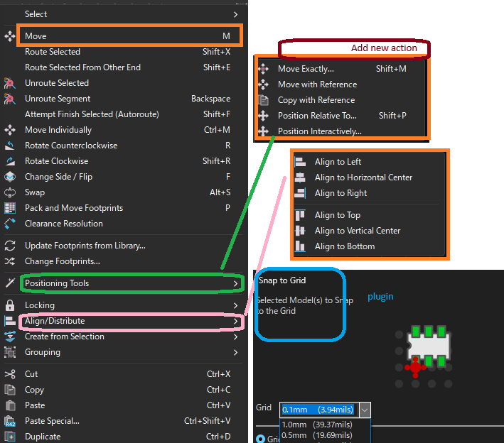

Do you think the problem could be solved by unconsciously choosing a variety of actions rather than just one?
  1. Set a small grid
  2. Use an action to move position
  3. Use the Align Action
  4. Enter a value in the properties
  5. Use various plugins
  6. Create a new incident (a new move action (equivalent to holding down the Shift key))
You can improve your work efficiency by carefully considering and defining the grids you use frequently in advance in the settings.

Sorry but I don’t really understand what you are trying to tell me with the rest of your reply. The more I look at grids in preferences the more I realise I don’t properly understand how to use them. However, in this case the components are not snapping to a grid, they are snapping to another component.
