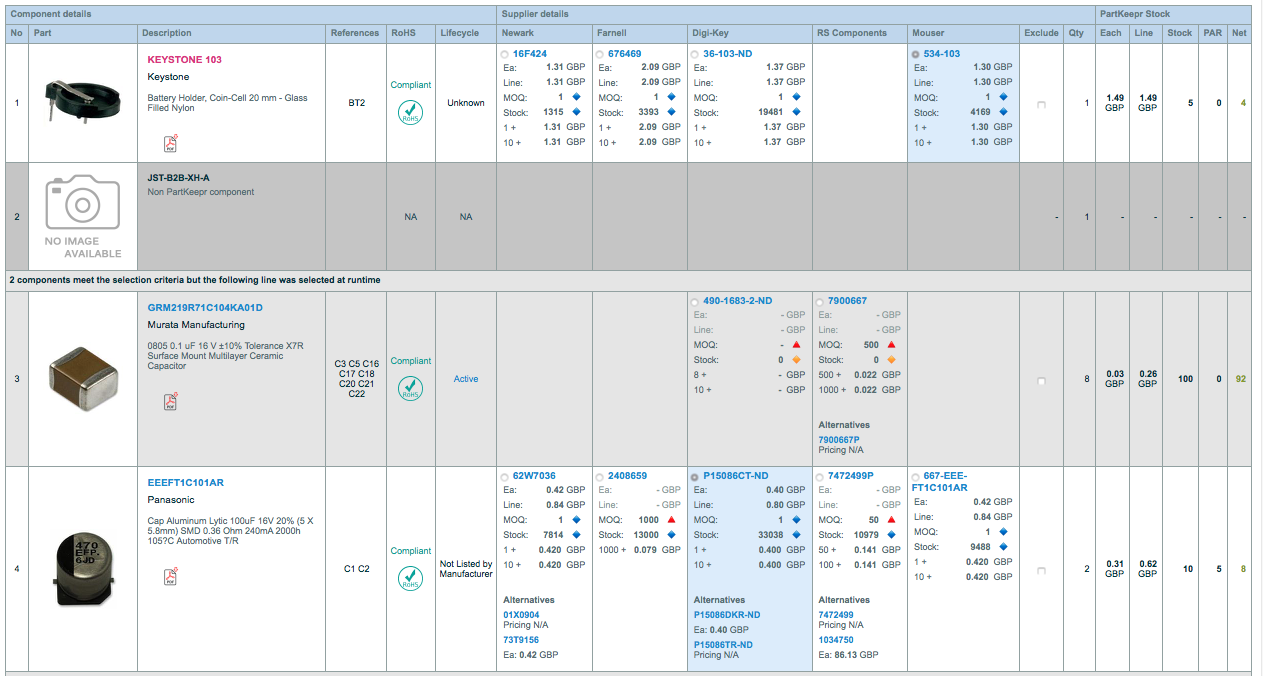

I wrote a tool a few years back KC2PK which illustrates two of the problems with this approach - especially for a solo developer and hobbyist user of Kicad.
I keep my electronic stock inventory in PartKeepr. It was a great program with a MySQL backend which could be interrogated for stock levels etc. it has now been abandoned and is a nightmare to reinstall on anything as it has an outdated and specific php dependency.
I linked this to access the Octopart API to pull in stocks and costs for a variety of suppliers. After a few months the API changed very significantly and I was just about to get around to a rewrite when my access token was pulled and Octopart refused to answer my emails.
I think this sort of functionality could be very useful for some users but it is always going to be built on the hope that the underlying API is not changed, access remains affordable and that some change in the EULA doesn’t render your project dead in the water.
