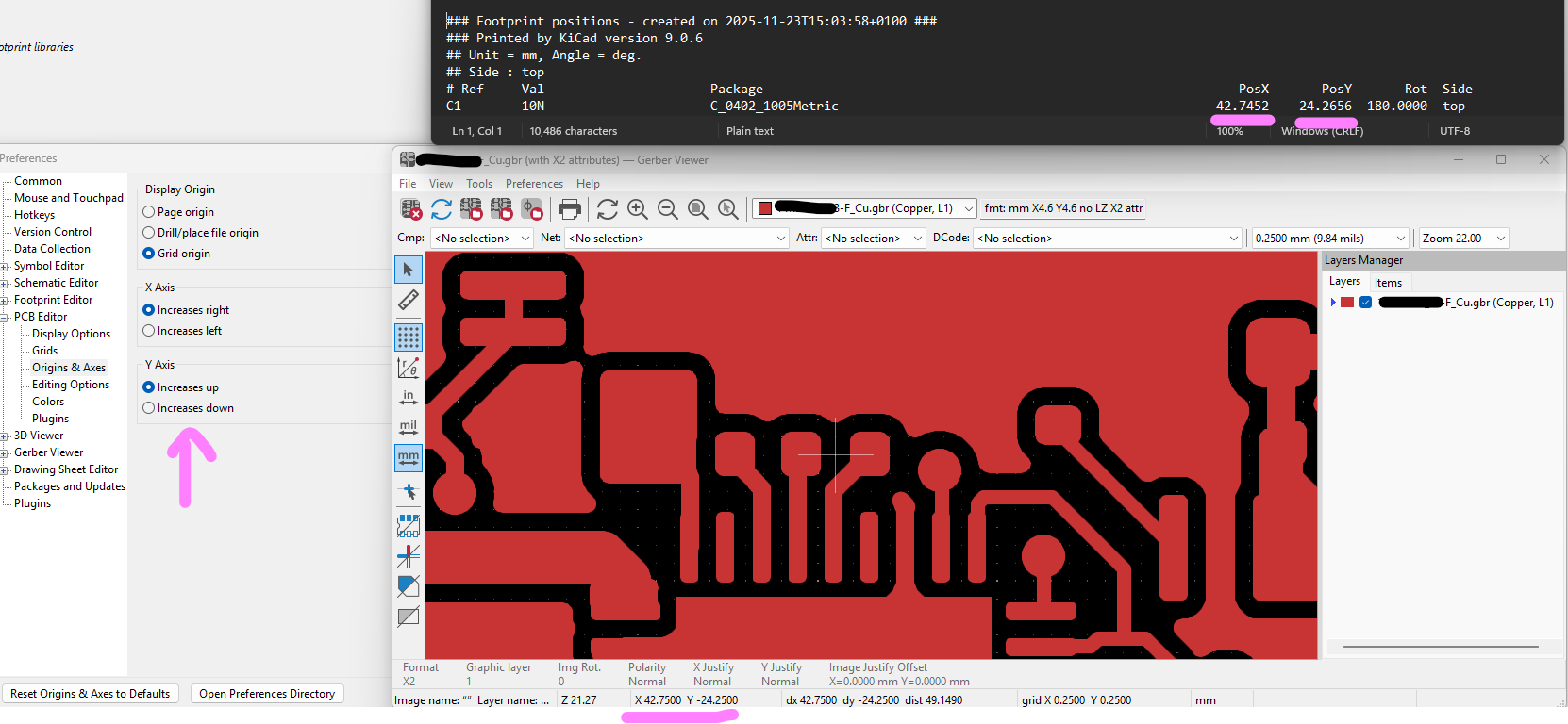

This topic has been brought up once before as a bug on GitLabs (https://gitlab.com/kicad/code/kicad/-/issues/13101) but the proposed solution (inverting the Y-axis in the settings) did not work for me and I figured I should ask the forums before declaring this a software bug.
Problem: All the Y-axis coordinates in the POS file I am generating are inverted (i.e. all Y-axis coordinates have been multiplied by -1). This remains even when I invert the Y-axis in the settings.

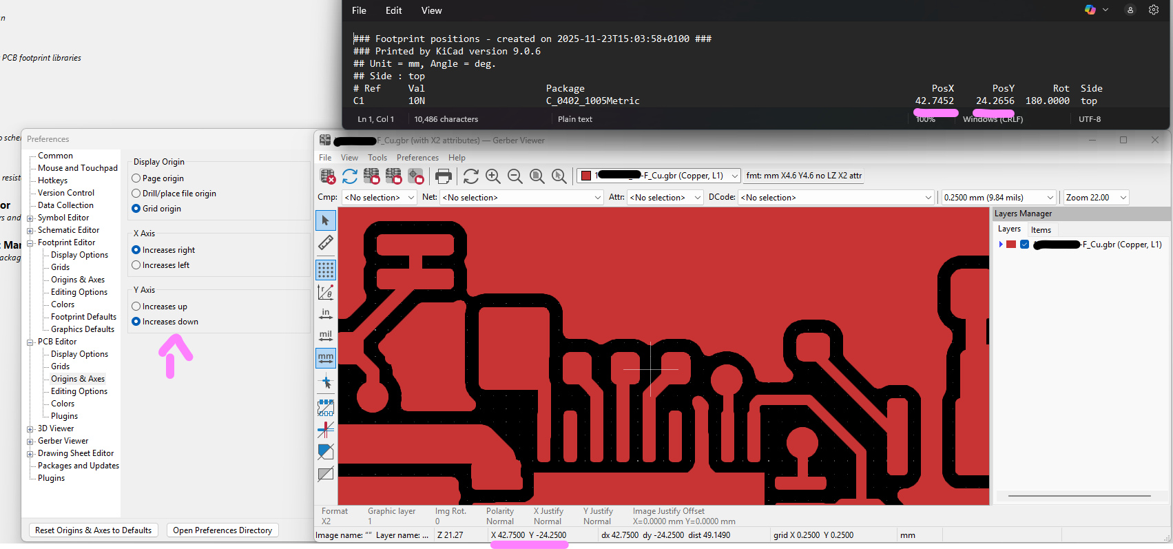

In the image below, the Y-axis has been set to increase when moving down. In the POS file generated using this setting, you can see that C1 is supposed to be located at X: 42.745, Y: 24.265. But checking the position of C1 on the Gerbers you can see that the component is located at roughly X: 42.75 and Y: -24.25.
After inverting the Y-axis in the settings, and regenerating the Gerbers and POS file, the same result:
My manufacturer is requiring that the coordinates in the POS file match the component’s location on the Gerber. How can I make the two match?

Preferences / PCB Editor / Origins & Axes is only for the visual canvas in the PCB editor. It does not influence coordinates inside KiCad or output files.
If you want to verify coordinates of the component placement files, then it’s best to use a program that can load both the Gerbers (IPC…) and the POS files. It appears that the .POS file can not be loaded by KiCad’s own Gerber viewer, but many people prefer to use software from another manufacturer anyway, just to exclude the possibility that an error in the Gerber files is interpreted in the same erroneous way by both the “Fabrication Output” function and the gerber viewer.

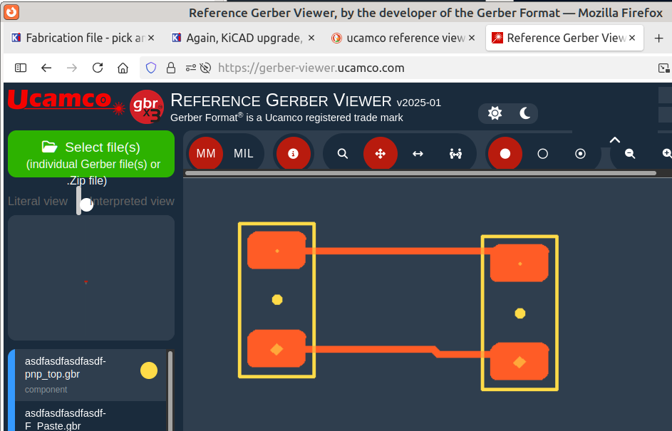

I did a short test in the Ucamco viewer (They are the creators / maintainers of the Gerber format)
https://gerber-viewer.ucamco.com/

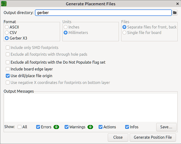

Together with the normal PCB layers, I also created a placement file with the settings below:
And Ucamco’s viewer shows them as dots:
I’m just a hobbyist myself and I guess there is no size information of the parts in these placement files.

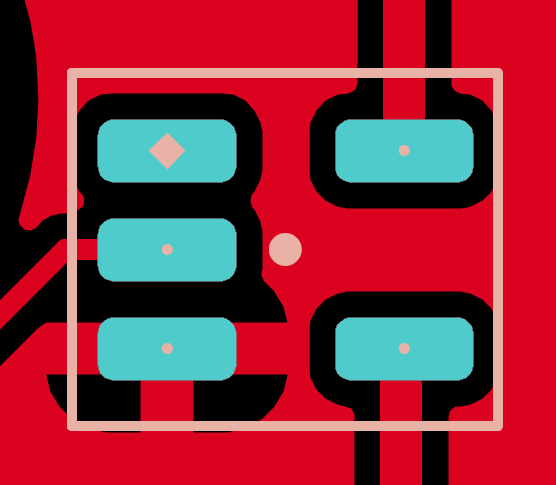

KiCad’s own Gerber viewer display the Gerber placement files just as well.
Not just dots:
There is a large dot for the centre, a diamond for pin 1 and small dots for the other pins.
