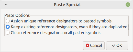

As indicated by others, when trying to reuse part of a layout in a new project, I first make sure target project schematic and pcb are synced, then I select and copy relevant schematic in source project, and do paste special in the new project’s schematic, then do ‘select on PCB’ for the source project and copy the selected layout in source PCB, then do paste special in target PCB, finally do target schematic and PCB sync. While it works sometimes, more often than not, the refdes are mismatched in target schematic and PCB. If it’s a complex circuit, I ended up spending lots of time fixing that, almost defeating the purpose of avoiding doing layout all over again. Please advise if I did something wrong in the process or if there is a better way to reuse layout.
You have to be very sure to use the option: Keep existing reference designators, even if they are duplicated. It’s easy to forget.

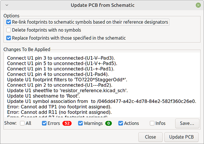

And this only preserves the RefDes, and not the (hidden) UUID’s, so you also have to use the option: Re-link footprints to schematic symbols based on their reference designators afterward. (And use this option once, only to sync, turn it off afterwards).
And you also have to make sure to resolve duplicated RefDes manually.

A better option is to first try to figure out why it did not work for you, and then re-do the Paste Special with the correct options. It’s easy to skip giving this process some conscious thought, because intuitively it should be “simple” and you’re probably focused on some other part of your project.
