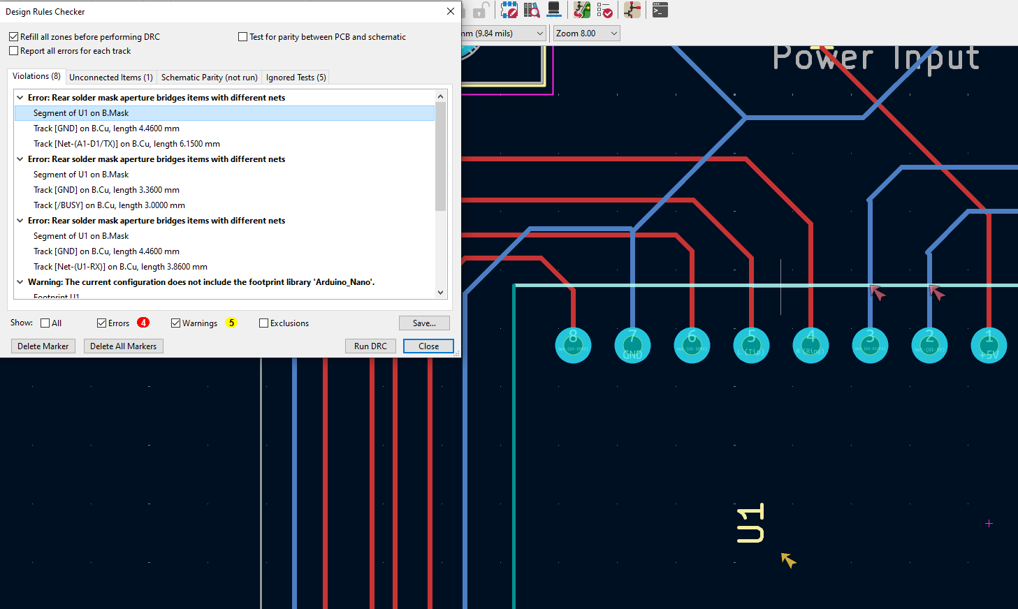

Error with segment of U1 on B.Mask
I’m new to KiCad and designing a PCB. When i run the design rules checker, it gives me the error “Rear solder mask aperature bridges items with different nets”. I’m not sure I know what this means or how I’m bridging those connections. The routes are all separate. It calls out a segment of the footprint (U1), which is weird. Is it saying the edge of the footprint is connecting my other routes (nets)? Thanks for any assistance.
It looks like the horizontal line of U1 rectangle be drawn at Mask layer what is senseless.
